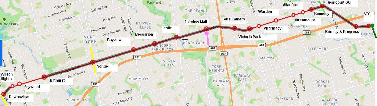

Sheppard Advanced Light Rail? After the Relief line and Yonge North ...
Thin red line: in the street median. Thick dimmed line: underground or on the bridge.
Phase 1: STC to Downsview.
East of Don Mills:
- Underground to just east of Victoria Park. Stations at Consummers and Vic Park.
- In the street median to just west of Kennedy. Stations at Pharmacy, Warden, Birchmount, Allanford
- Underground to STC. Stations at Kennedy Ave, Agincourt GO/RER station, Brimley&Progress, and STC.
West of Yonge:
- Underground up to West Don.
- New bridge over West Don, then another short underground section with a station at Bathurst.
- In the street median from just west of Bathurst to just west of Wilson Heights. Stations at Faywood / Wilmngton and at Wilson Heights.
- Short underground section leading to the Downsview station.
Vehicles: high-floor LRT that can easily fit in the Sheppard Subway tunnel. It will pose a bit of a challenge to design six surface stations as accessible. Either they should have raised platforms, or the vehicles should have low-floor sections. All stations should support trains up to 3-car length.
Maintenance facility: near Downsview, some unused parcels of land are still there.
Phase 2: from STC to Malvern via Centennial Progress campus.
Phase 3: west from Downsview towards Pearson.
Phase 4 (??): a branch from Centennial Progress campus to UofT Scarborough and then to the Rouge Hill GO station.
I think this is fantastic and a great compromise. I especially like the use of high floor LRT. My only question is the sharp curves at agincourt and STC, can the LRT vehicles handle that?
My picture is rather coarse, in reality the curves may be more gentle. There are no deep foundations in those areas that would force very tight curves.
Generally, LRT trains can handle tighter curves as well as steeper grades than wide subway trains. That ability might not matter much if the line stays on/under Sheppard, but the detour to Scarborough Centre should be easier to handle if we use LRT cars. Same goes for the possible future extensions east of STC and west of Downsview, the ability to negotiate tighter turns might save the construction costs even if we want substantial grade-separated sections on this line.
