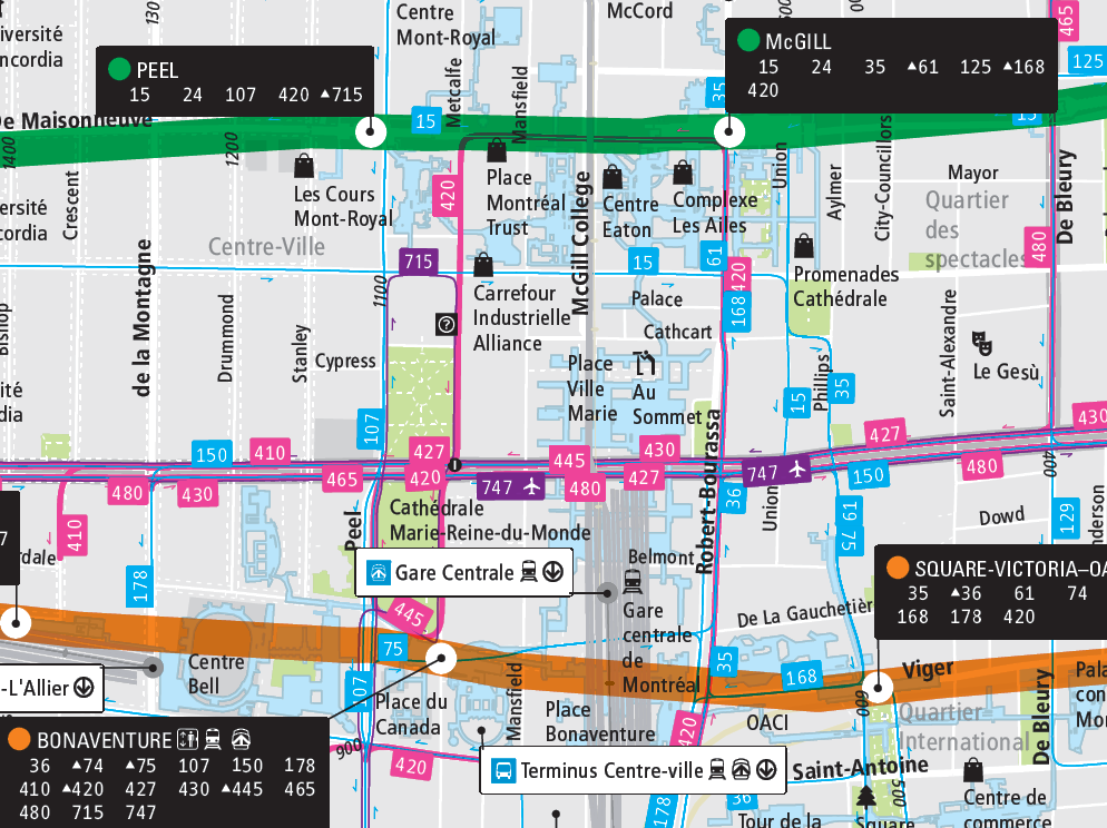

A bigger issue is the connection to the Metro at the terminus. Their figure makes it look like Central and Bonaventure are a single station. In reality, parts of Central are as close to Square-Victoria, and honestly, the slighter walk from McGill to Central seems simpler, as it's so much shallower than Bonaventure. I find the excellent STM downtown map (see below) very good at showing the relative locations of things.
What's missing here, unlike the REM which links to the Green Line well (and I hope there's some improved connections from the Central platforms into Place Bonaventure), is as good connection to the existing Metro lines downtown - though tough, given where Réné-Levesque runs.. However, isn't the Orange Line quite shallow (and straight) underneath Réné-Levesque? I wonder if there's any feasibility in adding a station there - that area has certainly developed since the Metro was first built, and if the northern entrance was at Réné-Levesque, then it's no closer than Place-des-Arts and Saint-Laurent.
But hang-on ... if you look at the map closely, they do mention and show an intermodal connection with the Orange Line! Is that really a new Metro station?

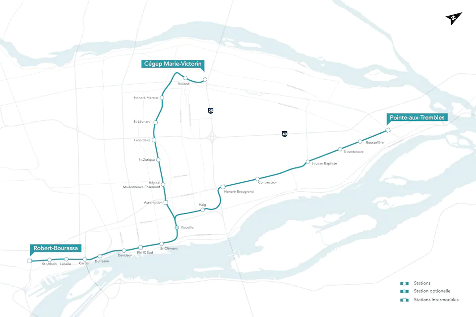

The northern terminus of the Montreal North branch is unclear. They say at Cegep Marie-Victorin, but the figure makes it look like just west of the Anjou Exo station. But they don't show an intermodal connection.
The driving route from Cegep Marie-Victorin to Central Station is interesting. Does anyone really drive that way (south on the 25, west on the Metropolitan, and then down Decarie and the Ville Marie) ? I suppose it's the only expressway route - but I take the 25, Souligny, Dickson and Notre Dame - or possibly St. Laurent and Park from the Met. I don't think whoever did graphic has driven down Decarie and between the 15s very often!
I would not bet on them adding anew station to the Metro. The images in the technical brief clearly shows the whole downtown segment is elevated. Berri-UQAM's closest entrance on Berri is a good 200m away from Rene Levesque/Labelle. It probably will be an elevated pathway of some sort. Or maybe a pathway to the closest underground path. (The university?) It is still possible to create an underground passage under the road. I have seen it done for Riyadh Metro. But Is very disruptive can add costs that the elevated alignment was meant to avoid. So I wonder what they will choose.
Given the station name, Labelle Station will probably is about here:

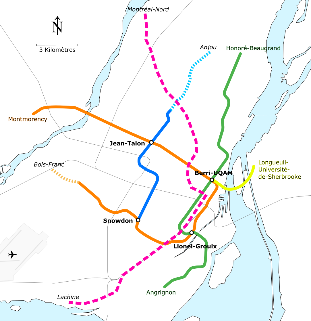

The current mayor's plan was originally to extend the metro up that way with the pink line.
The new "REM of the East" largely accomplishes the same thing but without providing the additional coverage in dense areas like the Plateau/Rosemont.

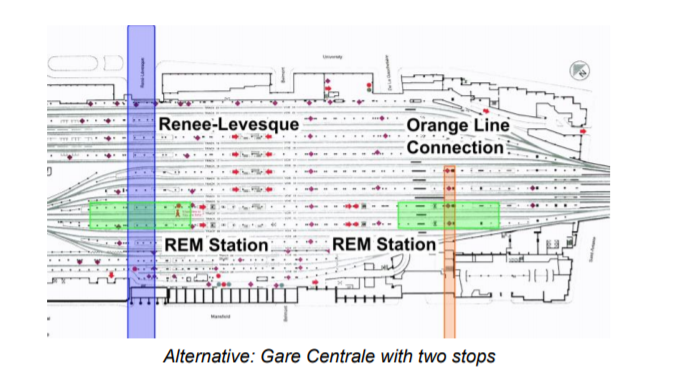

The connection from Central to the terminus should be pretty simple. Hopefully the final station is underground, but I"m sure they could have some long escalators from elevated as well, if they are willing to sacrifice road lanes.

Another idea: if they want to serve Montreal-Nord they could just finish what they started with the Mascouche line and make it an REM branch. The Mont Royal tunnel might be getting crowded but there should be space from the deleted airport branch.

René-Lévesque is not directly served by the metro for a good reason: it's too far from the metro stations. The closest official metro exits are at Beaver Hall (part of Square Victoria station) or at Windsor station (which is part of Bonaventure station). The REM running in that right of way doesn't solve that issue. That's why I think the better way to provide connections downtown is through the RESO.
The "Labelle" station should be located 2 blocks west at the intersection with Saint-Denis, where it could provide a connection to the CHUM super hospital on its south side (itself connected to the Champs-de-Mars orange line station) and UQAM just north of the station (connected to Berri-UQAM and the orange, green and yellow lines).
The "Saint-Urbain" station could easily connect to the Complexe Desjardins shopping mall to the north (connected to Place-des-Arts green line metro) and the Guy-Favreau complex and the Montreal convention centre to the south (both are connected to the Place d'Armes orange line metro station).
Finally the "Robert-Bourassa" stop can have a connection to Central station (where it's not so complicated to reach the REM Gare Centrale stop and further south the Bonaventure orange line metro) and Place Ville-Marie (connected to the green line McGill station further north). Also, the Beaver Hall exit of Square Victoria metro is not too too far from there, so that could also be a possibility.

I've seen some documents showing the layout of Grand-Centrale REM station, and from what I can tell they're making the connection to Bonaventure station quite quick and convenient.
