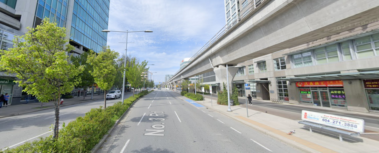

Richmond, No. 3 Rd
- Runs beside the road, both sides flanked by dense residential and commercial development. ROW width at about 35m, which is actually much narrower than Rene-Levesque which is ~45m, but roadway width is similar to that proposed by CDPQ (4-5 lanes)

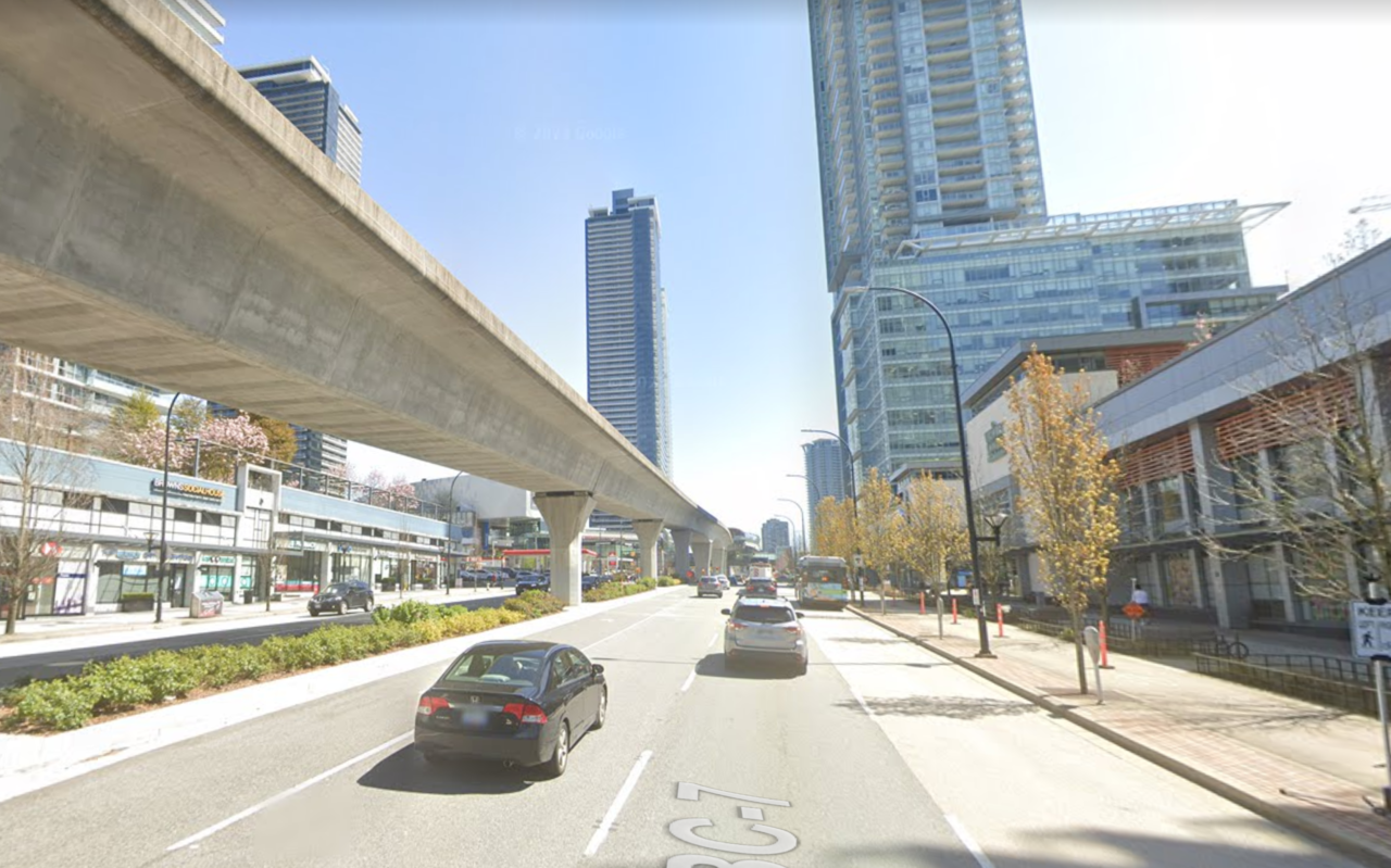

Brentwood Town Centre:
- Median running but on a road of the same ROW width as Rene-Levesque, at 45m. Actual roadway here is 6-7 lanes, CDPQ had proposed 4-5 lanes for Rene-Levesque so there would be more space for pedestrians/cyclists on RL. Again, also flanked by dense development.

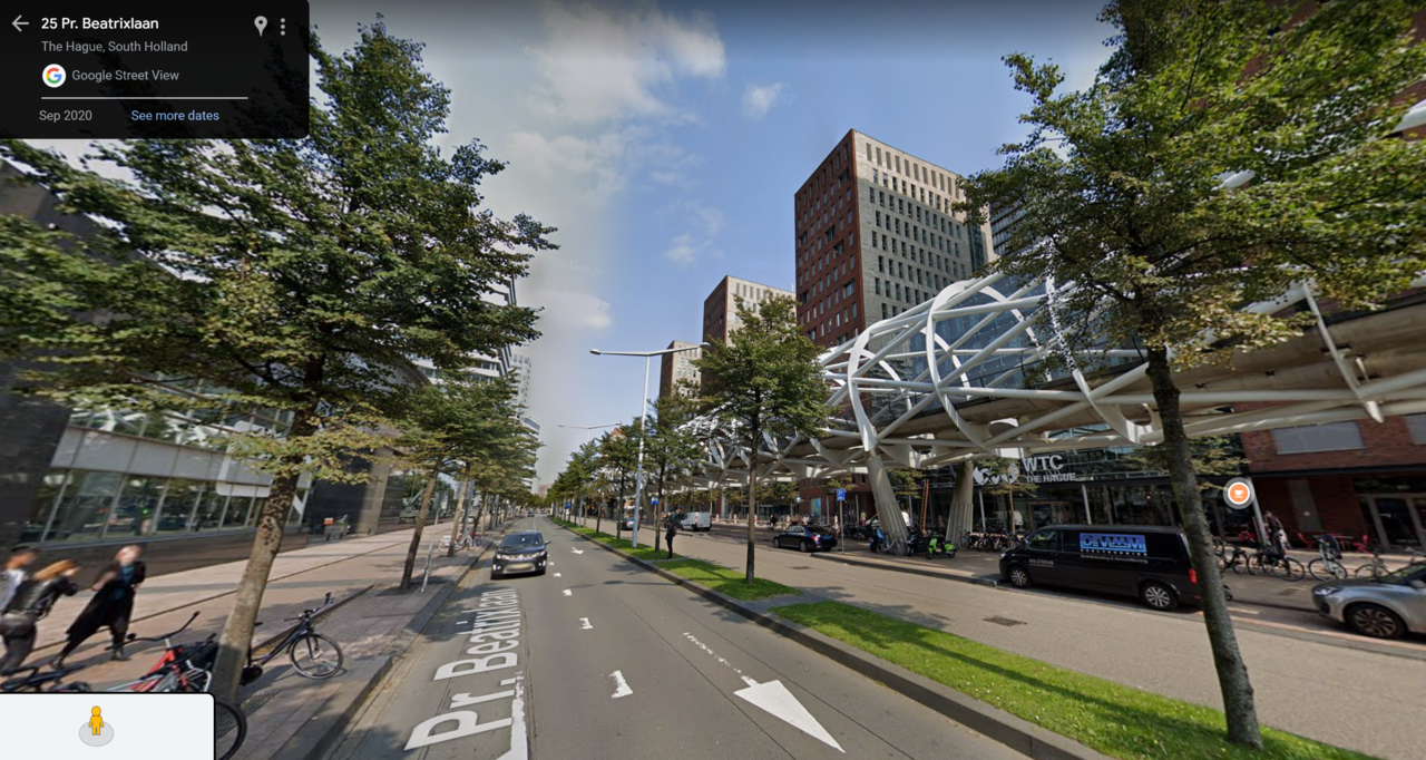

And probably the best example, Beatrixlaan in The Hague:
- Side of road, similar to REM Est proposal
- 4-5 lane road with bidirectional cycle track, again very similar to REM Est proposal
- Surrounded by dense development in the center of The Hague
And yes, this viaduct has the striking architectural features, but to be fair the CDPQ proposal was not a plain concrete viaduct either - it had a curved bottom with split pillars - certainly still much more thought (and money) put into aesthetics compared to the standard Vancouver Skytrain viaducts.

Richmond, No. 3 Rd
Right, so at least six lanes of traffic, not a vibrant high street, no heritage to speak of..........
See comment above, this is not a heritage high street, this is 8 lanes of traffic plus the median.
While the guideway is not particularly problematic in either example above, this is only because the entire roadscape is both overly wide and ugly to start.
Neither of these pictures appeal to me in the least as a place I would want to walk, bike, shop, work or live.
This is one of the nicest examples you'll find, but also not a historical downtown type area. Truthfully, for all the artfulness of the Guideway, I think this picture lacks much charm.

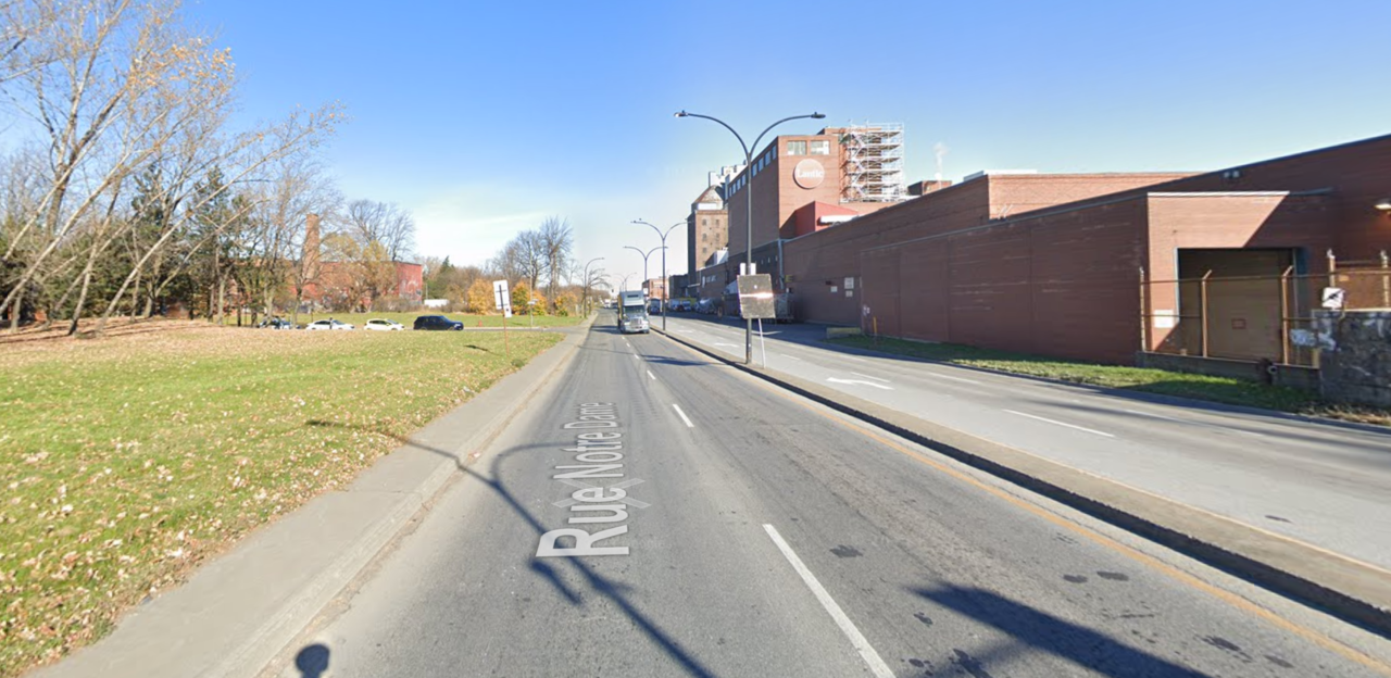

The above is arguably as a good a spot to go elevated as you'll find (though pretty darn good for shallow cut and cover too) .

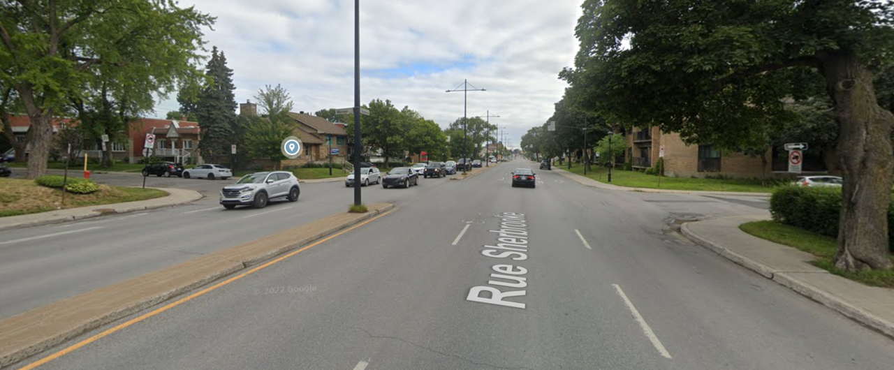

I'd be fine w/it here, on the understanding that this stretch of road is not now walkable (actually lacks sidewalks); but would also never become that pedestrian paradise (which is fine, not everywhere will be).
The above here is actually more problematic. First, look at how narrow he sidewalks are now. That would never pass muster w/today's guidelines. No cycling facilities, if you remove the middle 2 lanes for a guideway, and then the outer 2 lanes for adequate sidewalks and cycle tracks, you're down to one lane each way. On a road with lots of curb cuts and driveways too.
I'm very pro transit and building it cost effectively, but this looks challenging to create a reasonable outcome.

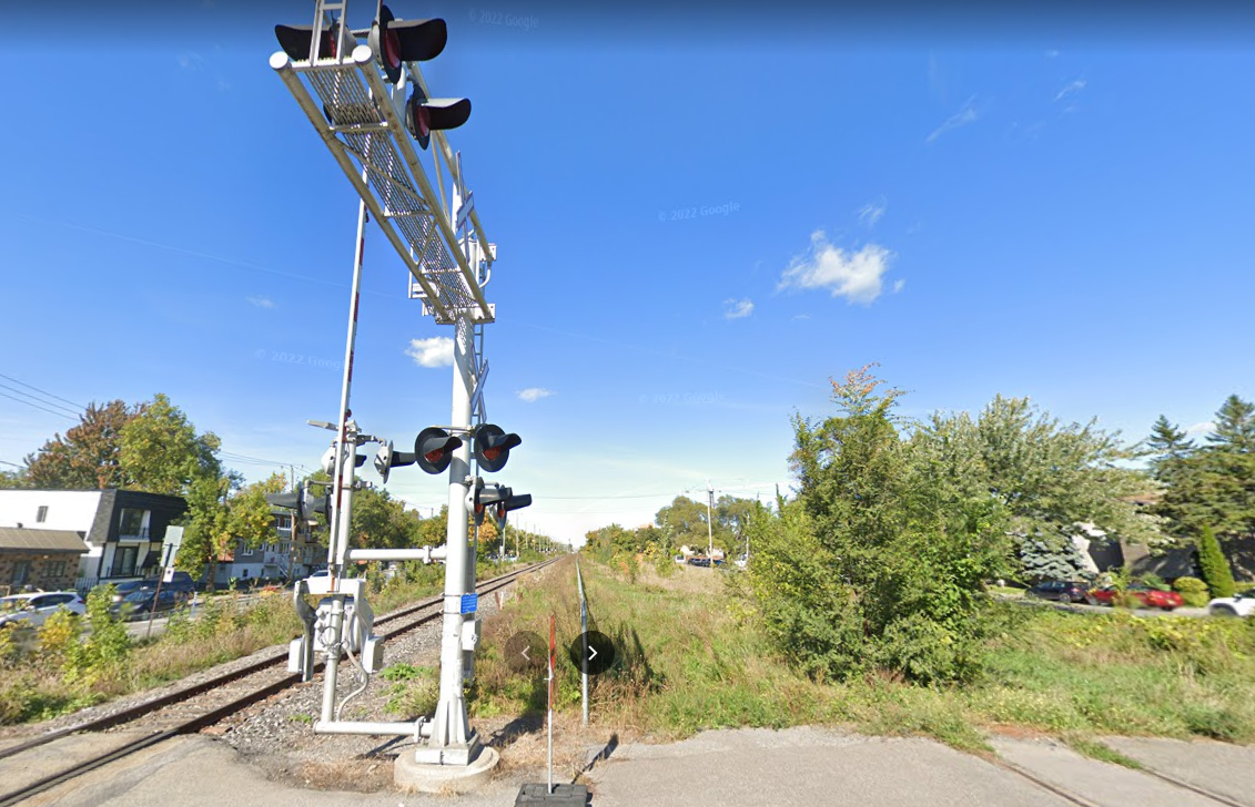

If one were to dead set on going elevated, I wonder why you wouldn't just follow the current/former CN Souligny ROW all the way? I know the initial modified CDPQ proposal included a short portion.
But it runs pretty much parallel to Rue Sherbrooke the whole way, just ~500m over.
To me, this looks a lot more logical that running over road:
