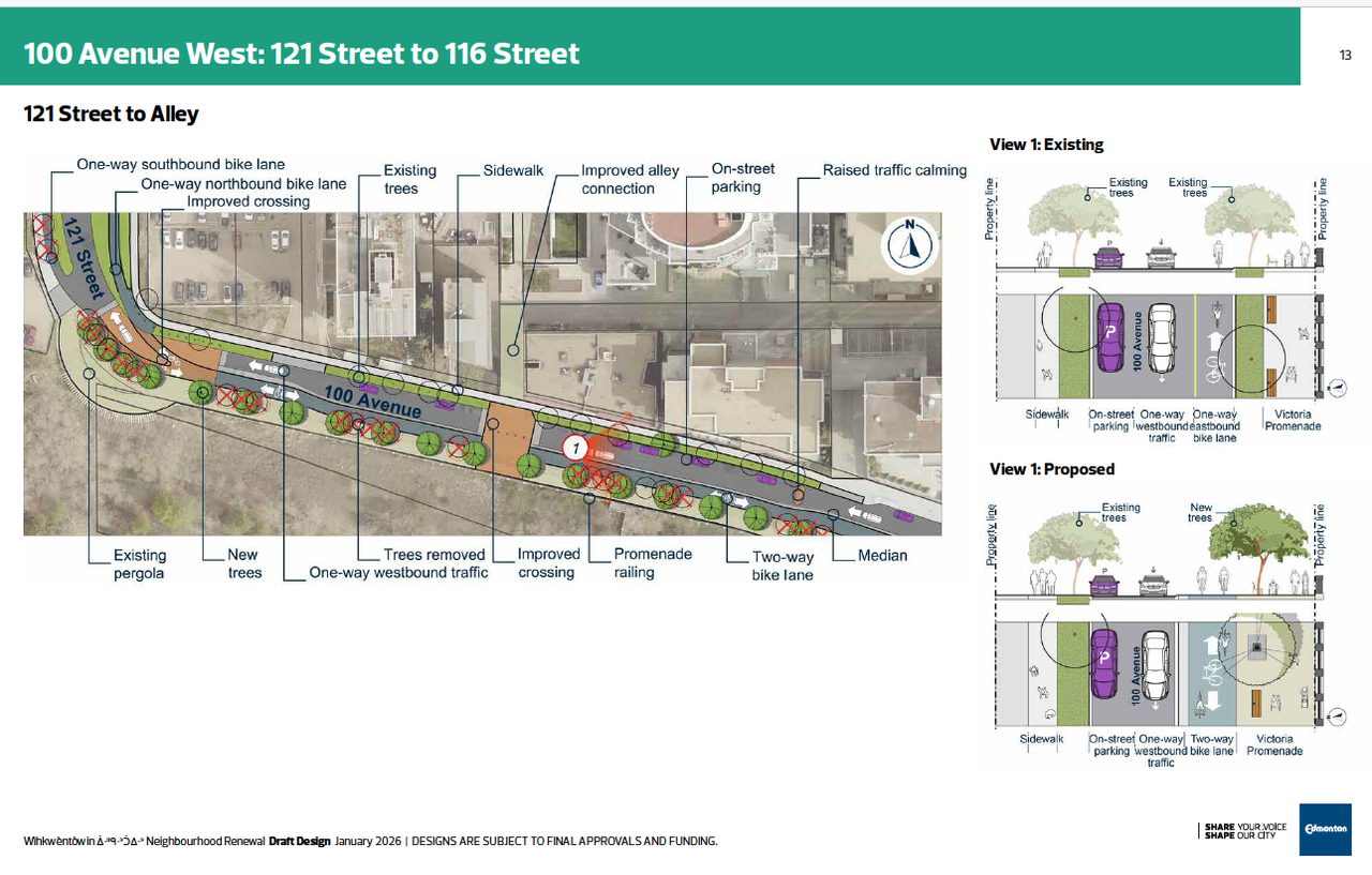

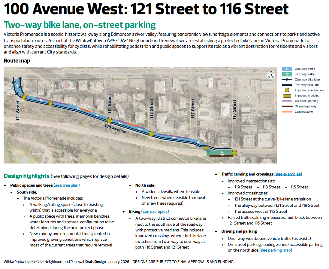

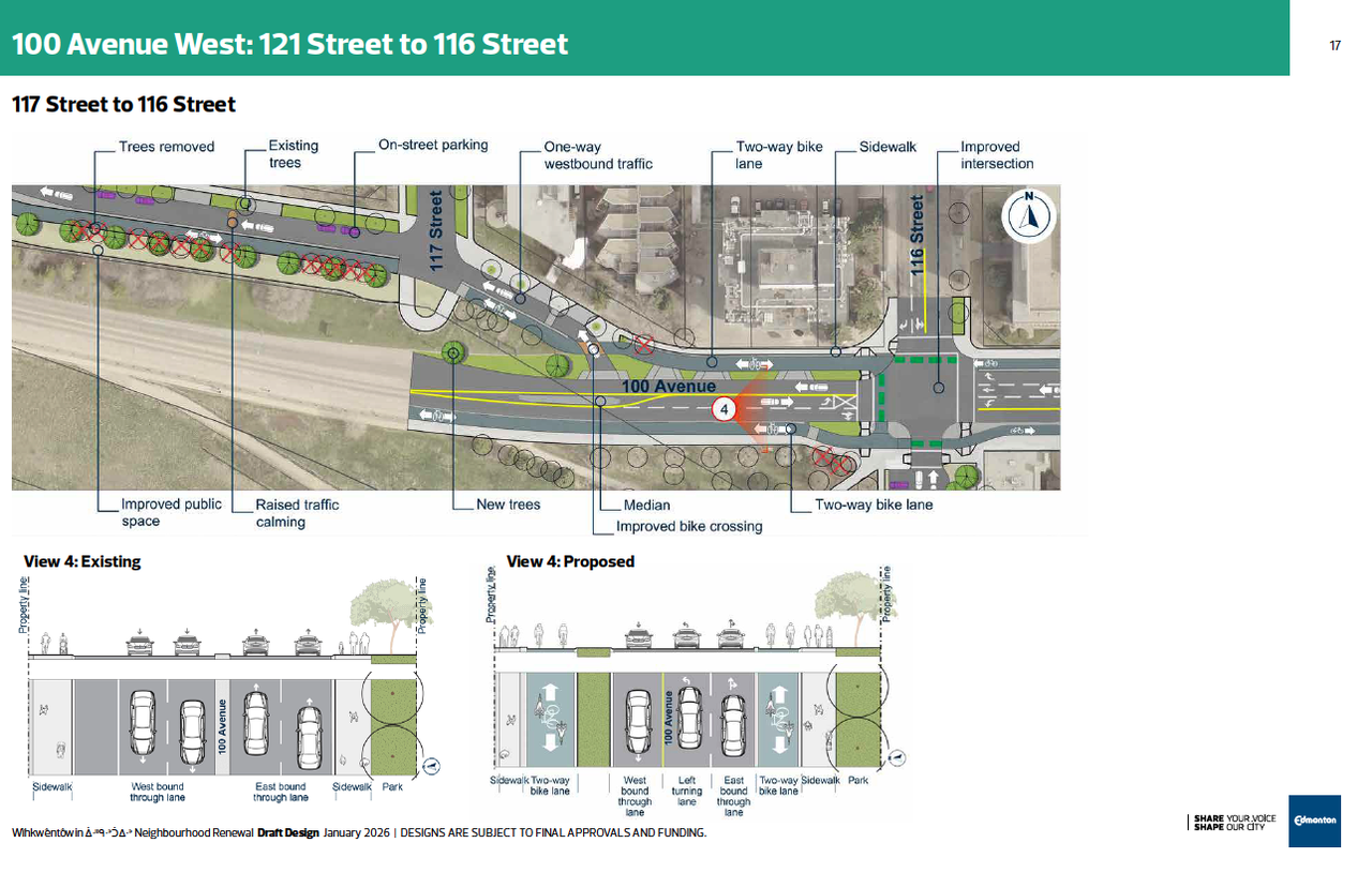

Community Feedback on Draft Design - January 2026​
Thank you to those who shared their ideas and feedback with us through the Building a Project Vision Together, Exploring Opportunities and Exploring Options and Tradeoffs project stages. The Project Team has now created a draft design that meets current City standards, policies and technical requirements and considers public input.
We invite you to review the draft design and help us REFINE it to ensure it reflects the Vision and Guiding Principles for Neighbourhood Renewal in Wîhkwêntôwin ᐄᐧᐦᑫᐧᐣᑑᐃᐧᐣ.
We want to hear from you!
  • Review the Draft Design
  • Complete the Online Survey
  • Join the Project Team for a webinar focusing on the draft design for 100 Avenue
  • Meet the Project Team at a Drop-in Event

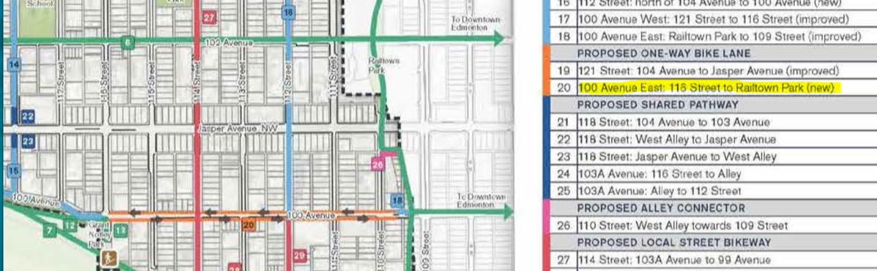

Isn't the 100 Ave renewal from 109 to 116 St being taken care of in another endeavor? Though I can't remember where.
Good news:
The 100 Ave bike lane extension west of 109 St is part of the Active Transportation Network plan.
Bad news:
They're proposing one way bike lanes on 100 Ave west of 109 St. Wouldn't it make far more sense to extend the 2 bike lanes west of 109 St?
