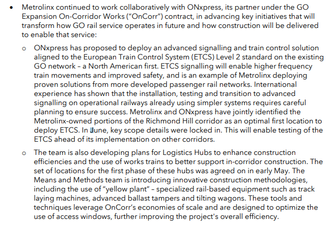

From the Capital Projects Group (GO & UP) report here on the September 12th board agenda.
I just saw this and looked back but couldn’t find what frequencies would be. Thanks!
The choice of the Richmond Hill line is very wise, and speaks to what a major technical challenge the transition to advanced signalling represents. RH is the least complex line with only moderate traffic. Best place to teach a workforce that has never built or maintained or operated this technology.
