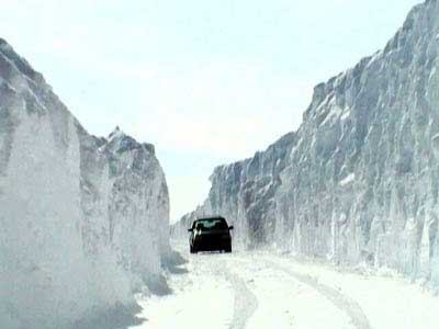

Even if they could connect QNS&L to the rest of the network, a link through Labrador would face winters like this:

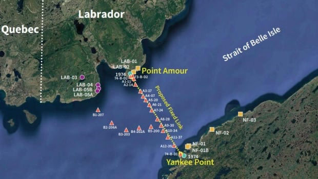

The idea to connect the island of Newfoundland to the mainland has been out there for a while. The common thought is a tunnel under the straight of Belle Isle. The good reason for a tunnel is the fact that a bridge would be potentially taken out by icebergs.
The real question is what is the demand for it. If the tunnel was built as a road tunnel, and if you finished the north shore highway, from Quebec City, it would still be faster to take the current route with the ferry, as apposed to this. The line, even if it went to St John's, would still have very low demand, and would be extremely long.
