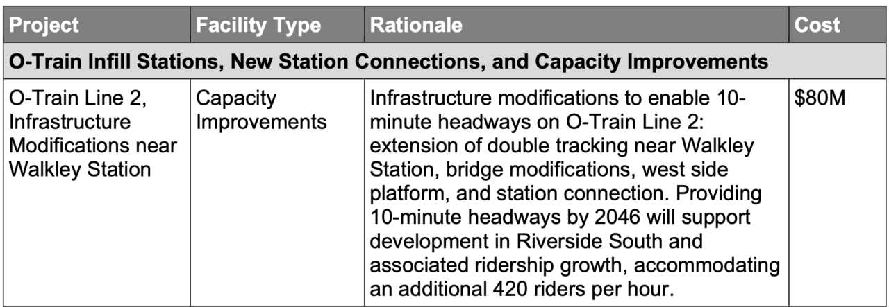

The 2025 Transportation Master Plan includes a (remarkably affordable) project to improve headways to 10 minutes, which could potentially be used to extend Line 4 to Bayview (every 20 minutes). This project would also cut a minute off the travel time by eliminating the waits that currently occur at the Walkley siding.

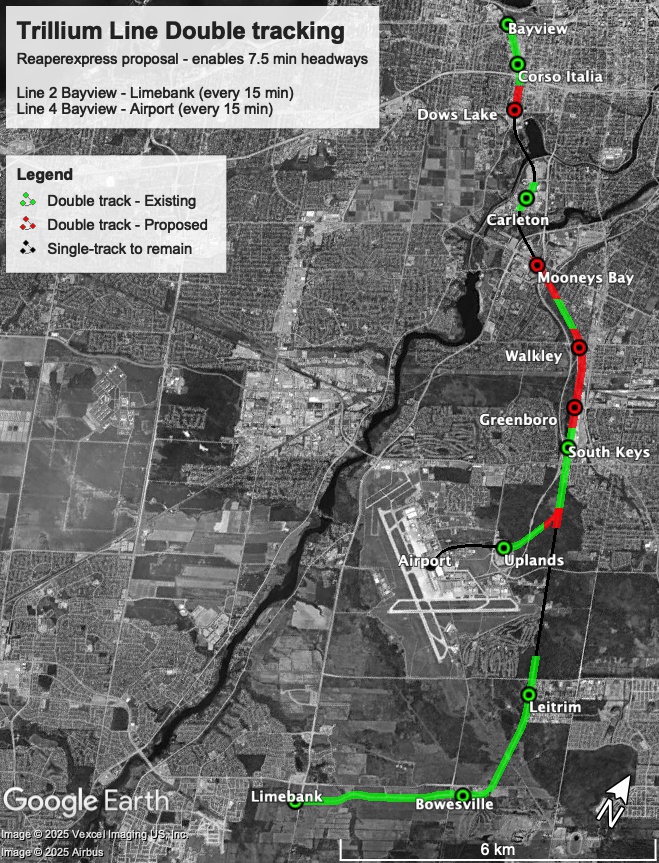

A more ambitious project could add a few more double-track segments to increase capacity to 8 trains per hour per direction, enabling Lines 2 and 4 to both run every 15 minutes to Bayview:

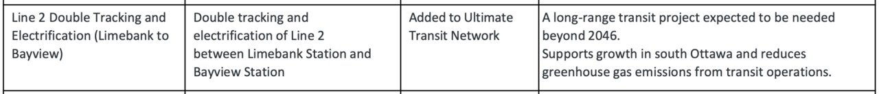

Full double-tracking was added to the Transportation Master Plan in the changes adopted at council yesterday, though it's included in the very long term (beyond 2046).

I assume the distant timeline is because the project includes adding a second Dow's Lake tunnel and Rideau Canal bridge, which would make the project incredibly expensive and destroy it's cost-benefit ratio. The smaller scope I proposed above avoids the need for either of those, drastically reducing project cost while still maintaining most of the benefits.
I like your map. I think I proposed the same scheme somewhere a few months ago but without so much competence😀 I don't completely agree that an extra hockey train is impossible. It would be disruptive and could likely only be done once per game, but holding northbound trains late evening to allow a southbound convoy would not be a service disaster. This week they are already debuting 24 minute evening headways due to equipment installation.

That’s crazy - I was under the impression that the the Stage 2 project was already supposed to achieve the max possible frequency without double tracking the tunnel. It’s frankly insane that this $80M of additional track wasn’t completed then…
Not even close. They did the minimum to stabilize the 12 minute headway. They could get to 10 minutes with Walkley doubled, which is not that difficult since the area for the second track and platform was leveled and it could mostly be built without shutting down the system. 7.5 minutes is a good goal, and 6 minutes could likely be done with everything but the tunnel, though I suspect ATC would be required to do that safely.

I'm not sure 6 minutes is possible in practice. The travel time from Carleton Station to Dow's Lake station is just under 3 minutes, so the minimum theoretical headway is 6 minutes. But that provides no margin of error so in practice it would be unwise to schedule headways less than about 7.5 min. We could probably save a bit of time using electrification and resolving the 25 km/h speed restrictions at platforms but I don't think we would get the travel time low enough to enable 6 min headways.
