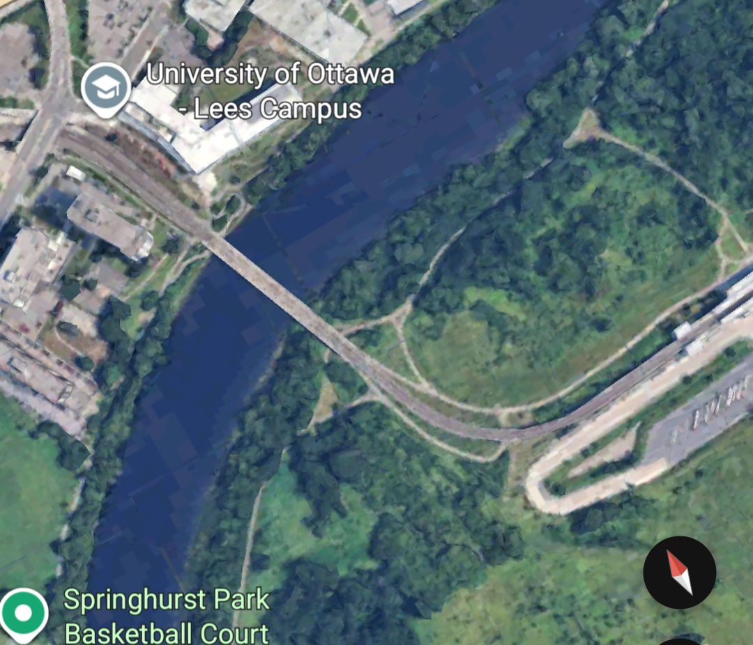

Some intense sparking on the LRT overhead in Ottawa:
OC Transpo reported a stopped train on the LRT Line 1 tracks at about 12:30 p.m. Wednesday afternoon after it observed “arcing on the trains” as well as damage to the the overhead wire system between Hurdman and Lees Stations.
Article content
“These impacts appear to be related to the severe weather event,” Troy Charter, interim general manager of OC Transpo, wrote in a Wednesday evening memo.
Seriously...
I know the icy rain was relatively intense but did we not spec transit in ottawa to handle ice accumulation?
Is something like this common in other jurisdictions?
Considering how overbuilt the OCS is in Ontario vs. France, you would think it could handle ice accumulation... Maybe the money for extra wires and masts was for form and not function...
It may be something more than just weather. This incident and the previous time both happened in the same general area, where the line travels near than over the Rideau River. They mentioned that there's a micro climate here that makes the freezing on the lines worse than in other spots
Maybe they need to consider something different here
Build a snow tunnel.
I don't entirely buy the microclimate argument. In the end, the wires were damaged in three different locations. There has to be a solution given that the March 11th storm was not that bad. There was only minor ice accumulation where I live. Every other means of transport worked better than Line 1. The train has to be more reliable than what was demonstrated. Four days out of service for the east half of the line is unacceptable.
