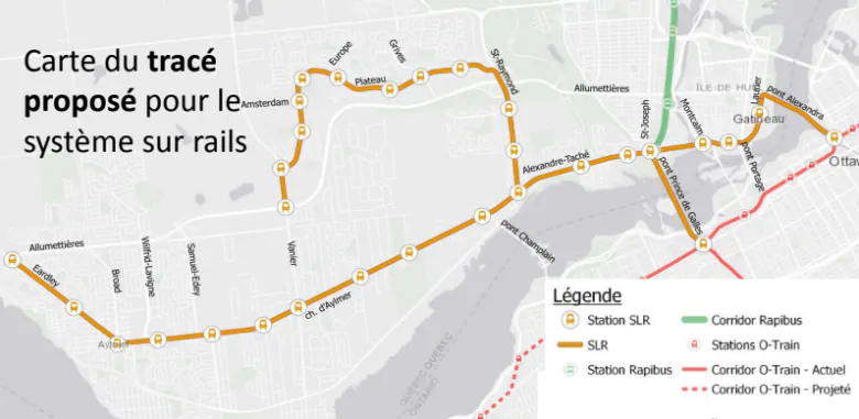

I think this plan is ill conceived.
The section that goes to Ottawa should not be their own LRT system; it should be an extension of the O-Train (Trillium Line) that would extend and replace the 'Rapidbus' section of the Gatineau network. The Trillium Line would then be re-branded into a regional train service.
Looking at the map, that's only a small fraction of this plan, across the Prince of Wales Bridge. I don't see that the Trillium line would work over the Alexandra Bridge, Laurier Street, or Boulevard Alexandre-Taché.
At the same time, this allows light rail cars from Gatineau to reach the Bayview interchange station between the Trillium and Confederation light rail lines. If the Trillium line was extended one further stop to Alexandre-Taché then many travellers from Gatineau would have to change twice to get to downtown Ottawa, instead of once.
If they ever do build light-rail along the BRT Rapidbus line (green below) then perhaps that should be revisited ... though optimally, I'd think running both the Trillium line and the Gatineau LRT over the bridge might be optimal. Though with the current single-track span over the Ottawa that would present challenges!
The map is a bit out of date with the latest proposal, where the SLR actually uses the Portage bridge and connects with Lyon station, and the Trillium line is extended across to Terrasses de Chaudière
I only looked at what was provided in the article linked above! That should improve the proposal.
One one hand, that will force more transfers for those that want to head further west in downtown. On the other hand, using the Portage bridge, will get people to the west side of downtown, rather than Alexandria, that would dump people east of the canal at the Rideau Centre!

Would you know where a copy of that map exists? IE the latest proposal
From the on-going consultations. There's also a write-up about the various scenarios.
If the Prince of Wales Bridge were chosen to be part of the structuring system, riders going to Ottawa would have to transfer to Ottawa's light rail at Bayview station.
However, the light rail section between Tunney's Pasture and Lyon stations will be the busiest along the Confederation Line. There would not be enough space to accommodate all riders coming from Gatineau.
From this aspect, the Prince of Wales Bridge does not meet the needs of the current study and has not been retained. However, its use is still relevant for a secondary link between Ottawa and Gatineau. In fact, it has been identified in Ottawa's transportation plan in the ultimate network concept.
