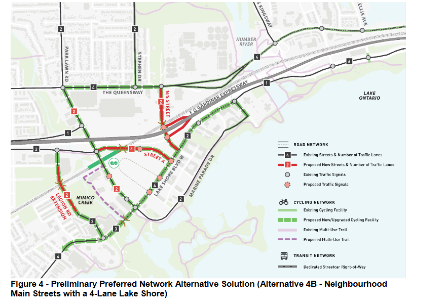

Preliminary Preferred Alternative below:
interesting, seems the city doesn't want the relief road to connect directly to the gardiner, but it does make sense to just add another connection from queensway because that's largely what the relief road would be offloading... but it also means the entirety of 2150 would have a longer route out than originally proposed
considering the on ramp has lights, wouldn't it make sense to connect the relief road anyways? it's not like they'd be waiting for traffic from the on ramp
The biggest surprise here for me, and it's really underplayed in the report, is TTC abandoning Humber Loop. Though by doing so, and moving the tunnel further east, they do finally better serve the the Humber Shores area.
If you follow the Mr Christie site redevelopment, Humber loop move to the loop for the development on day one. The existing tunnel will remain unless the single eastbound Lake Shore lane becomes 2 way.
The current thinking city level is changing the eastbound off ramp to allow 2 way travel on the Lake Shore from what there. It would allow the new Lake Shore LRT to remain 100% on the lake Shore than going up to the Queensway that was approved in 2010. This surface in the Waterfront Reset study and will require an new EA.
I pushed this new route during the EA for Lake Shore back in 2008 and since then.
I don't live in Etobicoke, so I don't follow too closely. I was aware of the plans for the new loop at Park Lawn, and extending 501 Humber services to there. But I'd completely missed the plans for a new tunnel that bypasses the existing Humber loop!
Good to see the dedicated ROW extended to Legion as well. Bit-by-bit, they Waterfront West LRT appears.
If I understand correctly, there is no new streetcar tunnel.... rather, once the streetcar passes through the (deactivated) Humber Loop and the existing tunnel under the Gardiner, it runs on the surface in a dedicated ROW west to a new loop near the GO station. ?
I'm a local resident, and while the option chosen is probably the best one, I just can't imagine the road network being able to bear all the traffic once the Christie precinct is developed. The extension through the Sobeys plaza is a clever way to distribute traffic coming off the Gardiner, but the intersection at the Queensway is already backed up simply on the basis of traffic to the mall. Once connected to the Gardiner, the left-turn cycle north to west will have to be extended, reducing throughput on the Queensway.
I wonder how long the Food Terminal will hang in at this location. Truck traffic on Park Lawn and the Queensway is already hell.
The OFT ( I think) is likely to stay put.
The truck issue could be addressed by dedicated connections for trucks from the Gardiner to the OFT.
If the OFT moved............think how much more new development would take its place! It wouldn't address the traffic much. The OFT site is larger than the Mr. Christie's site.
That's what I'd always assumed - but the figure above clearly shows the streetcar crossing the tracks/Gardiner, and joining Lake Shore at the intersection of Palace Pier Ct and Lake Shore - about 300 metres further east than it does now at 2111 Lake Shore West.

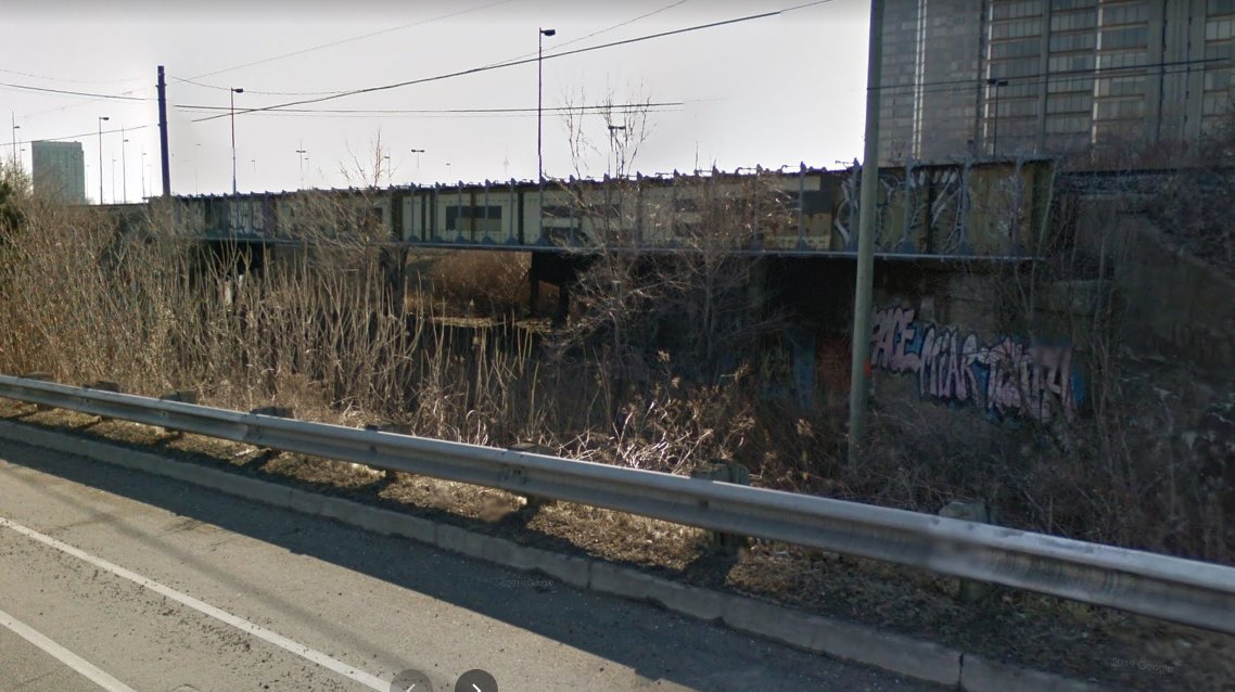

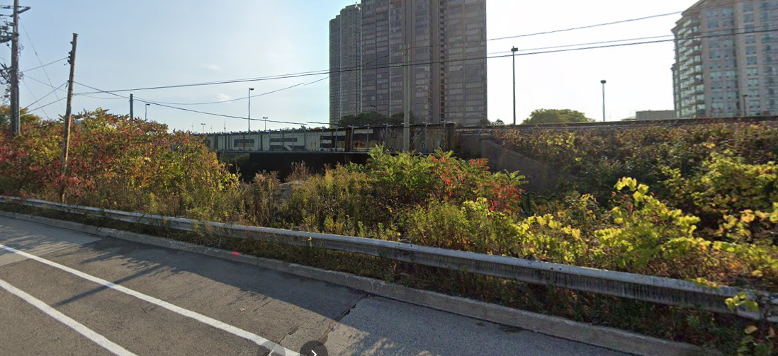

Perhaps they can reuse the old CNR bridge over the previous Queensway alignment, that was abandoned when they moved the Queensway in the late 1950s.
I don't see any point in maintaining the existing tunnel, unless it's just for pedestrians.
You know, it's not too often someone makes me go.....'huh'......about Toronto....... (so, Thanks)
But I had to use Streetview to find this.
I'm sure I've passed it before......but with my eyes looking forward on the road, probably never given it a moments thought. It's also not terribly visible when the vegetation is in leaf.
