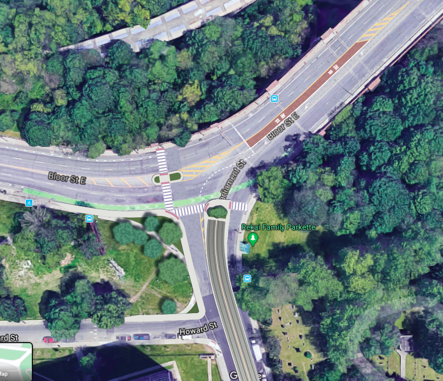

Re: running the Parliament streetcar through a tunnel portal south of Bloor St and to/from Castle Frank on the lower level of the viaduct: I really like the idea of activating unused existing infrastructure. I know it seems prohibitively expensive, but I took a stab at a reconfiguration of the Parliament-Bloor intersection that is, if not cheap, at least conceivable. In the spirit of Vision Zero, I added some other elements to improve pedestrian safety and comfort (no more slip lane, shorter crossings, protected medians, trees to shelter the sidewalk), as well as a queue jump left turn lane for the 94 Wellesley bus, which would get a priority signal. There would ideally be no RTOR for eastbound traffic on Bloor St, to make the crossing safer and to give priority to WB vehicles turning left onto Parliament.
Portal design and dimensions are based on other portals in the city (e.g. QQW and Spadina). Track spacing in the streetcar ROW may not be 100% accurate, but the overall ROW width is more or less correct. Note that a left turn from Parliament NB to Bloor WB is not currently allowed, and that is carried over to this scenario. Also note that I am not a planner or a civil engineer (but would be interested in feedback from anyone in those professions).
While you lose a westbound lane on Bloor in this configuration, you also don't really have to stop westbound traffic except when pedestrians are crossing Bloor.
You're not? Could have fooled me, the drawing is spot-on! In fact I don't see a single drawing or pavement marking error, which is a feat some professional planners and engineers don't even achieve when submitting drawings for review!
My main thought is that the portal should be further south for a couple reasons:
- The subway alignments under the bridge are close to the edges (under the curb lane if I recall correctly). In your picture the northbound track would need to do quite an abrupt turn underground to line up.
- Moving the portal frees up space on the northbound approach of the intersection. This could be used to either shrink the size of the intersection east-west, or to provide a second northbound right turn lane (which would allow the east half of the crossing to get a walk like sooner, giving them a head start westbound while cars are still turning left on the west side).
Also, why did you provide a westbound left-turn bus lane? Wouldn't the bus be replaced by the streetcar? Eliminating that lane would free up space to provide a more substantial buffer on the bike lane along the bridge.
I really like how you provided two-stage crossings for both directions. I realize that multi-stage crossings have a bad wrap in North America due to the hamfisted pedestrian-unfriendly way they tend to be timed, but it is also possible to use them to actually reduce delay for pedestrians (and the intersection overall). In the Netherlands, for example, there are multi-stage crossings everywhere, and they're timed to give a green wave for pedestrians across the various stages. This creates more opportunities for pedestrians to get a Walk signal (like the example I gave above) and also reduces the delay for other traffic (since they only need to wait for pedestrians to cross a couple lanes).
