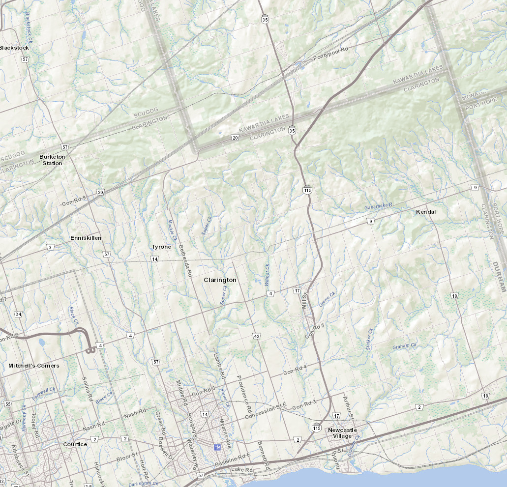

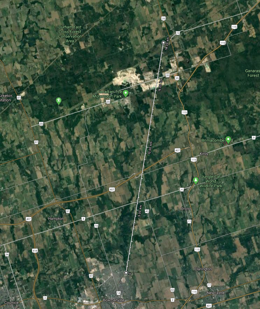

That's an interesting idea. I make the distance a little longer - from the northmost point of the curve in Bowmanville to the west end of Pontypool is 18 km, but that's still not a huge amount to build, especially when you figure that the alternative might require a similar amount of new trackbuilding along the Belleville Sub from Pickering west to Leaside. Connecting the havelock line to LSE might delay or eliminate that need.
What's more of an issue is - there is an awful lot of wetland in there, lots of creeks. And a very significant rise in elevation particularly as one climbs the ridge from Leskard north. That would be a rise of 122m in five miles as the crow flies, or about 1.5% grade end to end.
