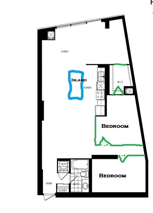

That's a huge layout with only 1 bedroom and not much window space.
The entrance door opening outwards is very odd.
It looks to be a loft space in an old building.
How high are the ceilings and does the space gets much light?
The thick wall separating the den and dining room looks like it could be structural and could not be moved.
I would make the den and dining room into two bedrooms and open the wall between the old bedroom and living room so that you expose as much window and light to your living space as possible. You could still keep the existing walk-in closet, but move the door to the opposite side so that it opens to the newly created bedroom.
Is there a possibility of adding another bathroom? For that size of space it really needs it.
The entrance door actually does open inwards (from what I remember) despite the depiction here - in any case is that a bad thing for any reason? By the way, this will be my first condo, so I'm new the condo thing (and the tiny sizes!).
It is not a loft space (per se) and the building is less than 10 years old. It is definitely a peculiar unit for several reasons and not a layout plan that the builder sold or has in any other unit in the building.
Very interesting idea re moving the master bedroom altogether, and I agree 1000% with you re the need for another bathroom (especially if this is made into a 2 bedroom) - I'm just not sure how much renovations can be done in a condo typically (i.e. can new plumbing even be put in in a building?). My issue with the 2 bedroom plan though is that then none of the bedrooms would have any windows! I'm not sure how much of a deal breaker that generally is. And also, not sure if the layout allows to have 2 bedrooms in that dining+den area comfortably. How would the separate work? Something like the attached? I thought bedrooms have to have a window + closet? Actually, given that the window faces the highway, maybe it makes even more sense for the bedroom to not have a window?

Excuse the crude MS Paint edits.

Having inboard bedrooms would not be an issue in a loft or in a unit that has high ceilings, which I mean at least 10 feet tall, to allow for walls that stop short 3 feet to allow for light.
As this is a newer construction, most likely concrete construction, it would be either impossible or outrageously expensive to add plumbing for an extra bathroom.

See attached for a 1+1 with 1200 sq. ft. layout.
I think they could have made the layout a lot more functional with all that space, but this is a one-and-only unit with this layout.... thoughts? (By the way, I am a new member looking for input on this layout from people on here, but it turns out I can't post my own thread until I have 20 posts... so rather than spam the forum posting 20 posts quickly for no reason, I figured since posting a floor plan IS the subject matter of this thread, I could do it here and still be legit!)
With re to dimensions, as I mentioned, the suite is 1200 sq. ft. (1 washroom for such a space is not great).
The den is approx. 8-9' x 13'
The bedroom is smaller at approx. 10' x 10'.
From the right end of the dining room to the left end of the unit is approx. 25'.
I generally don't like the fully open concept layouts where the kitchen is basically the wall of the living room, but my thought was to put in an island to designate a larger area as the "kitchen".
Any ideas on setting the unit up efficiently with couches/TV, etc?
