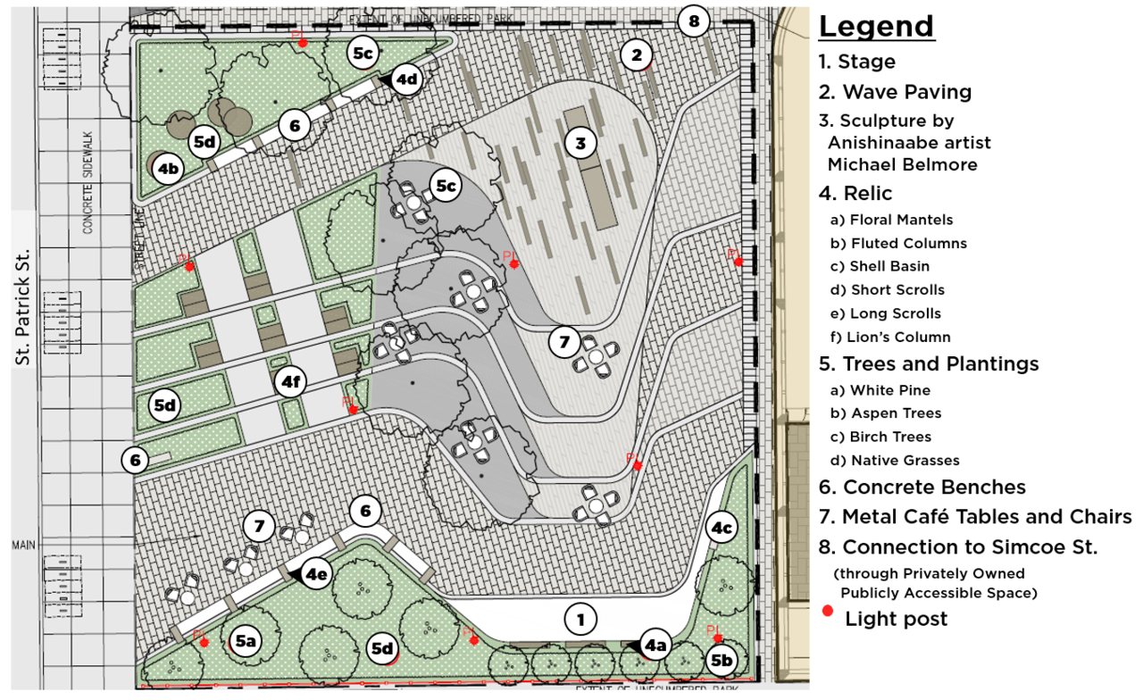

Ok, let's move on to the second 'Relic' Park, this is the one on St. Patrick Street, that is part of the Artist's Alley space.
While still small at 1000m2 it is roughly 4x the size of the space on Dundas, so there is a bit more play here:

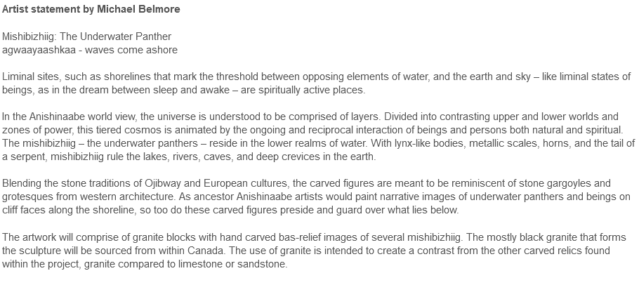

Indigenous Sculpture:

Better organized than than the smaller space with the sculptures at the centre of the space and seating oriented to view same.
Some potential issues w/tree species selection. I like all of these, all are native; but all are sun lovers, which this site does not have in abundance. White Birch and White Pine are not known for their tolerance of highly urbanized conditions either.
I don't have an hours of sunlight chart for this space, but the Landscape Architects should, and should double-check there is sufficiency. The Aspen are also sun lovers, but more urban tolerant and a reasonable choice here.
Also questionable from an urban tolerance point of view, but I might go for adding Beech here, as they are shade tolerant.
Site plan does not show any drinking fountain - every park should have one!
Otherwise, I'm not super excited about the space. But I think it looks functional'ish and could add value.

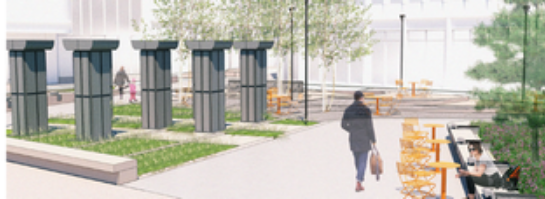

Renders:
So, based on what I'm seeing here, we appear to be looking north from Dundas. McCaul is out of frame to your left, the new building to your right.

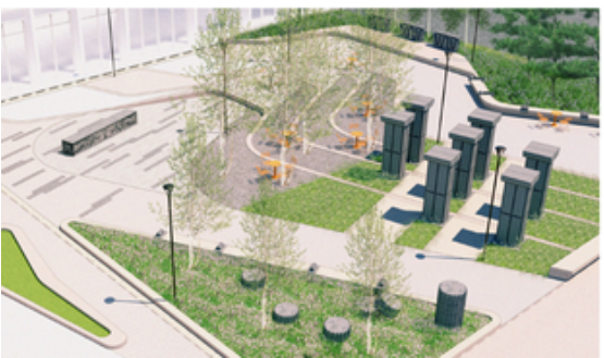

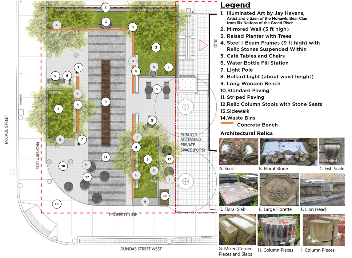

Here's the layout scheme:
I'm going to start by noting there's no way I'm wrong that the render shows 5 trees, but the above shows 4; inconsistency is an issue.
Seating total in the schematic above is::
7 round seats
1 long bench seating 4-5 (my estimate)
4 'cafe' tables with 9 individual chairs.

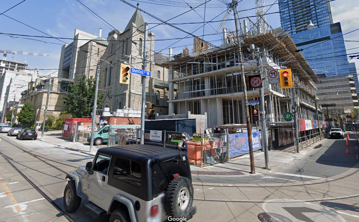

A picture of the site as is, current streetview: (Sept '23)
I think we need look back at the renders of the adjacent project to get a better understanding of the space:
So this park will be up against high ground floor glazing.
Immediate thoughts:
Why a water ball filling station w/no drinking fountain? They are available as an integrated single piece, the fountain part is not an expensive add-on. No cup/bottle, no water for you! Not sure how how inclusive that is.....
Second thought: Why are we not integrating the sidewalks seamlessly into the landscape? Given how small the landscape is that would seem a no-brainer. We have to retain a pedestrian clearly, but we can use augmented paving materials
and consider the space in relation to the design. Depending on sidewalk width it may be possible to 'borrow' some space at the edges.
Third thought, I assume the mirror wall is meant to make the space feel larger; but I'm not sold.
Fourth thought: Why are we generally obscuring the only attractive building adjacent to this space with the mirror wall and vegetation, instead of celebrating it?
Why wouldn't we hide the monstrosity to the east if we could?
Fifth Thought: The functional program isn't too busy, but the 'vision' is ........... you've got 3 real competing ideas here.

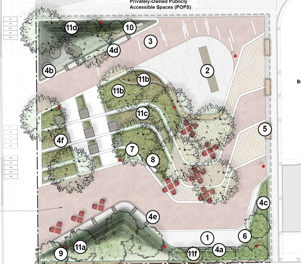

Comments:

This one changed a bit more than the one above, so I'll post the new renders:
Notable here is the shift to red/pink toned interlock for much of the space from the previous grey. Also the addition of more seating w/back rests.
Additionally, more trees were added in the central space; and the species mix was adjusted a bit. Meaningfully better.
