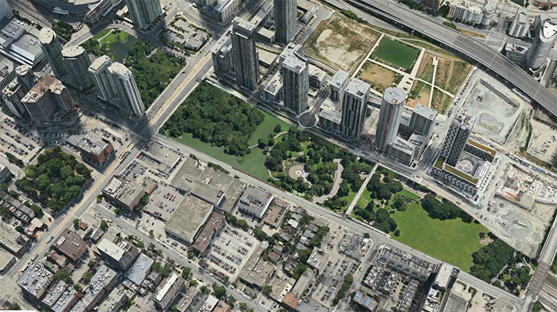

One problem is that the trees in such a park will take decades before they get big enough or mature enough to cast worthwhile shade.
co9u0_yxeaa35_o-png_large-png.82667
Hopefully, the city will have a nursery or farm growing the tree saplings now, to be transplanted when ready.
Would like to see a variety of edible fruit trees planted, like apples, cherries, or peaches. Not just trees for show.
Not necessarily - given the experiences at the waterfront. The question might be whether the deck can handle trees that grows to a significant size.
