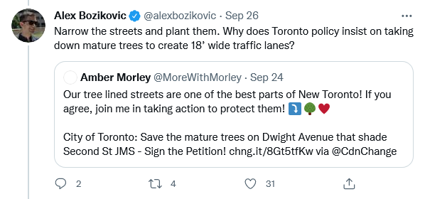

Soooo, our own @AlexBozikovic has a thread going over on Twitter, which I will link below, in which he expresses some exasperation with the City's Road Design guidelines (on that he is not wrong); in this case
in relation to a project to install one long block of new sidewalk, in front of a school, on Dwight Avenue in Etobicoke.
Twitter thread here:
From said thread:

So, my thoughts:
1) The road design guideline, with a 5.6M drive lane here is nuts, I'm all for revising that guideline.
2) What Alex does not mention in his thread (that I noticed) was that the road is not being resurfaced or reconstructed, the sidewalk is a stand-alone project. As such, in the City's terms, the design guideline isn't all that relevant, in that they have no desire to open up the road to build the sidewalk. Its not a small matter, as the existing curbs and gutters (sewer grates) would need to be relocated as well, the necessitates open up the road and the road base, its a much more expensive project. I'm not arguing against that, per se.........but its important to consider that even if the road design were narrowed, the project would be vastly more expensive and not within the approved budget.
