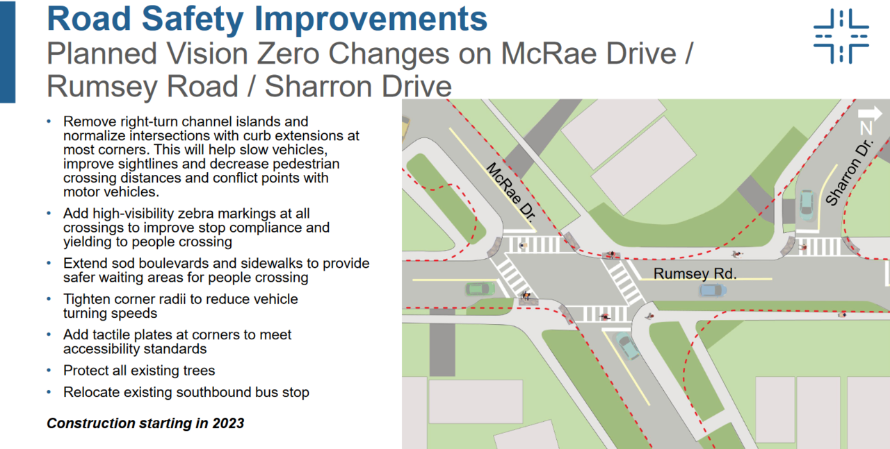

Changes coming to some Leaside intersections as part of Vision Zero:
From the presentation, I found this interesting:
Report briefly notes some steps to shifting mode in the form of:

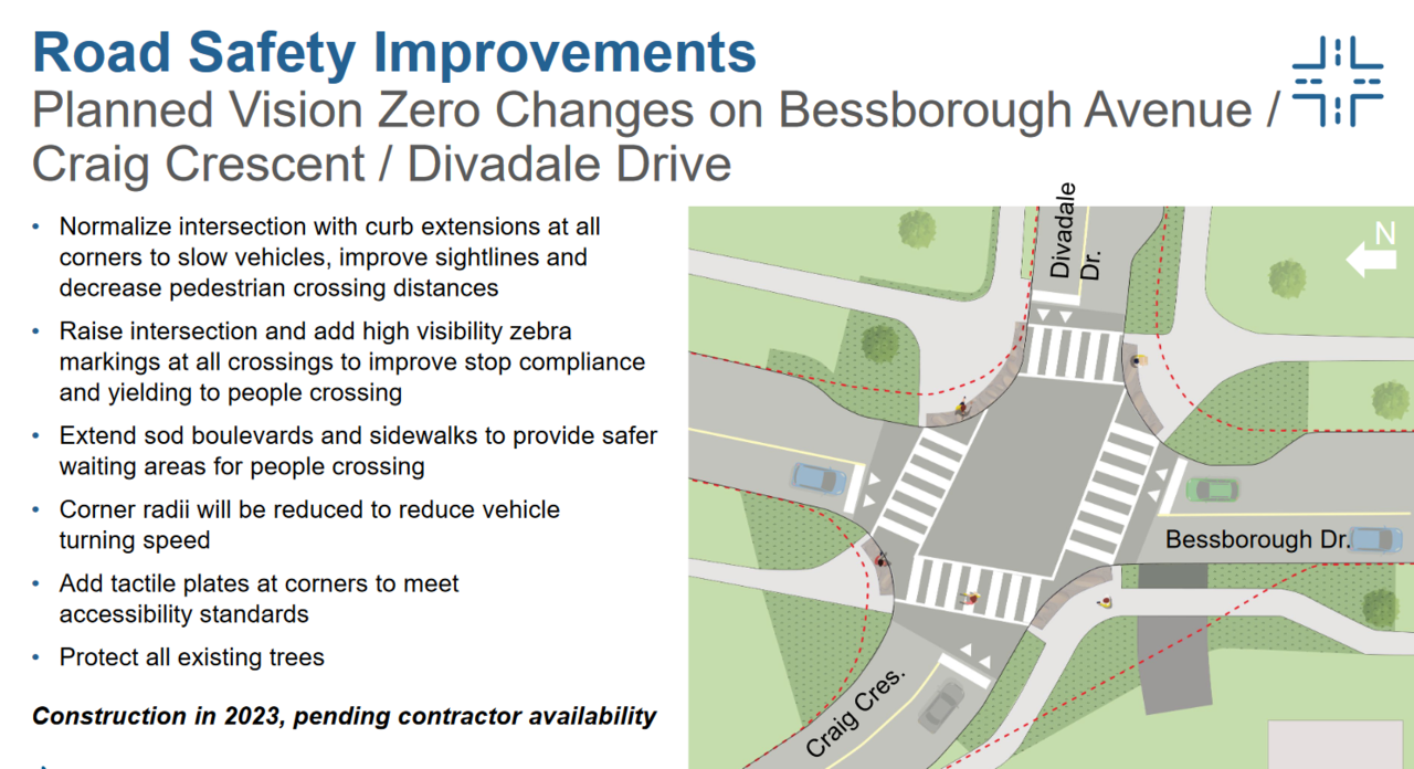

Any insight into why Toronto prefers using asphalt for raised crossings for minor streets like Bessborough? It would seem that best practice is to use the sidewalk material to emphasize that the need to yield to pedestrians (cars are crossing the sidewalk, not pedestrians crossing the street). It feels like a missed opportunity, one that might erroneously lead to conclusions that raised crossings don't produce the expected safety benefits.
I don't have that now, but I will ask; and get back to you.
@afransen ; I have your answer(s)
1) The choice of asphalt is based on people w/low vision being able to infer that the space they are entering permits cars.
2) The Ontario Traffic Manual and the Transport Association of Canada have generally discouraged continuous sidewalks across roads.
Though, apparently have just released a paper suggesting a possible change of direction.
Edit to add: @reaperexpress ; have you read the above?
I'm just reading it now, I see that right off the bat they are using an example from The Netherlands......

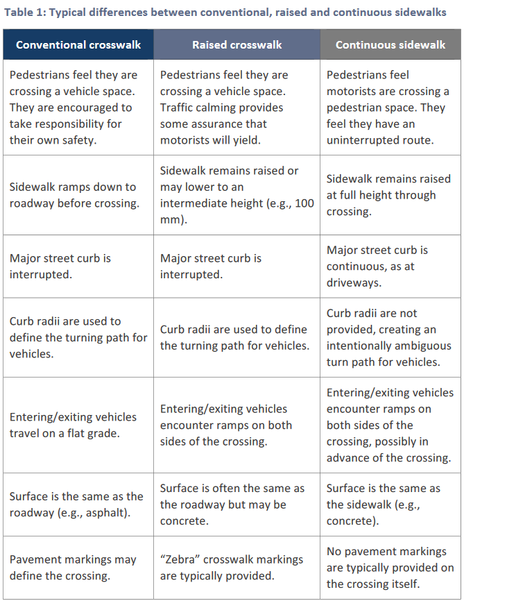

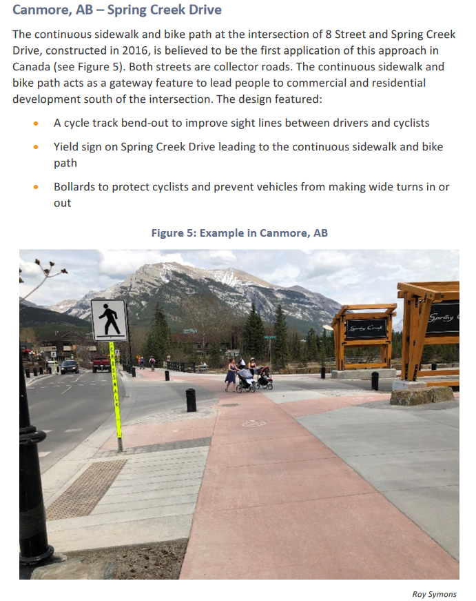

I would encourage those interested to read the paper itself. That said, I'll bring forward a couple of items people might find useful/interesting:

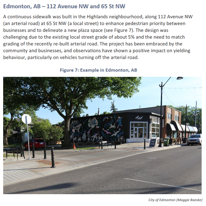

Canadian examples of continuous sidewalk:
Once again, the above from: https://www.tac-atc.ca/sites/default/files/site/doc/publications/2023/epb-csbp-e.pdf
Interesting to see Edmonton a leader here again..........they were the first major urban centre in Canada to abolish parking minimums.
Now leading on continuous sidewalk.
Edmonton is far from an urbanists paradise, but clearly making some strides in recent years.
Edit to add: @reaperexpress ; have you read the above.
Thanks for digging. I guess based on those guidelines, the Bessborough intersection would likely be suitable for a continuous sidewalk, but the City is taking the more conservative approach of a raised crossing. It is encouraging to see some international best practice is percolating into Canadian practitioner's thought leadership.

,but the City is taking the more conservative approach of a raised crossing.
The City's internal guidelines for cycling and pedestrian infra are being revised as we speak and have been evolved quite a bit in the last few years.
There was certainly a great deal of room for improvement; and there remains more distance to cover.
But I think its fair to say current staff are very much aware of that and trying to evolve the standards in the right direction.

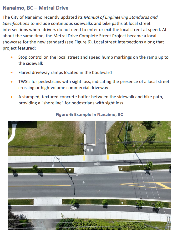

Here's some more information on Metral Drive in Nanaimo, from the Transportation Association of Canada no less. The Nanaimo design has a tactile strip to alert the visually impaired that they're entering space where vehicles cross. Edmonton too by the looks of it.
A New Standard for Raised Local Intersections
With successful implementation, numerous awards and considerable industry interest in the wider adoption of continuous sidewalks and bike paths, ISL representatives are working with other practitioners on TAC’s Active Transportation Integrated Committee toward a new synthesis of emerging practice focused on continuous sidewalks and bike paths. This report will build awareness and hopefully support enhacements to TAC’s formal design guidance, and is expected to be finalized later in 2023.
Street View
This is very good. I would say it would be ideal if there was room for cars to wait between the cycle track and the roadway so cars can avoid blocking the cycle track when waiting to turn, and for cars turning onto the minor street to navigate the oncoming traffic conflict without needing to proceed immediately through the cycle track instead of splitting focus between cars, cyclists and pedestrians all at the same time and needing to 'gun it' in their window.
