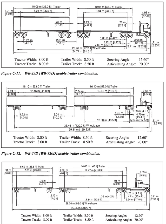

Then there are the double-trailers...
I would like to be as far from the intersection when those trailers make any kind of turn.
I would want to be a block away from the triple trailers...
Vehicle load and dimension regulations are really complex, but generally speaking, the maximum combination vehicle length in Ontario is 23m. There is a 'long combination vehicle program' that allows up to 40m but there are a lot of restrictions.
