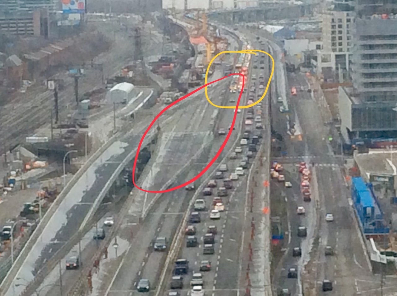

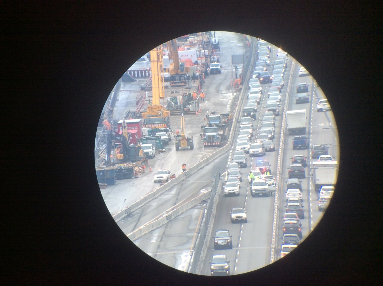

We observed the aftermath of a crash this morning before 7 am. A truck appeared to have driven straight into the barrier. Twitter said the driver was seriously injured. Crews are working there now, see photo below.
Jan 26th 2020 another car spins out.
You may have posted this before.
Is the speed limit 80 km/h, and motorists are expected to make a sharp ~30 degree turn over a ~12m length?
I would say that ramp is designed for 40 km/h.
Is there space to the lower left of your photo that they could have had some type of radius (double curve) on that off-ramp (I think your suggest above was just to increase the gore, and not to provide a smooth radius)?
There are probably multiple actions could be taken. I suggested a wider opening and pushing back of the barrier and that could allow a smoother turn with reconfigured lines etc. I do not understand why there is so much open space to the west that could be used. I reported this to the city a while back, they told me it was under-consideration. I bet signage is poor but I haven’t driven that portion for a while. And of course a larger collapsible barrier would save injuries. And a slower speed limit would help.
In the yellow circle is where the accidents occur. Within the red area is plenty of room to re configure the barriers.
Looking at the situation and using common sense:
  1. I suspect the most common accident would be the exiting driver going faster than the exit was designed for (maybe 40 km/h?) and crashing into the attenuator at the start of the concrete barrier.
  2. Next would be the exiting driver slamming on the brake when he realized he must slow to a ridiculously low speed to make the exit, and gets hit from behind.
  3. Finally, it would be the exiting driver slamming on the brake when he realized he must slow to a ridiculously low speed to make the exit, and the driver behind swerves to the left lane to avoid rear-ending him, and sideswiping the car on the left lane due to the sudden lane change.

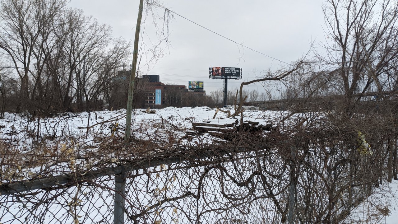

Not sure if this land clearing is for expanded Go Train storage, Gardiner Hybrid, both or other.
It runs between the the big fabrication tents and the Lower Don River Trail.
