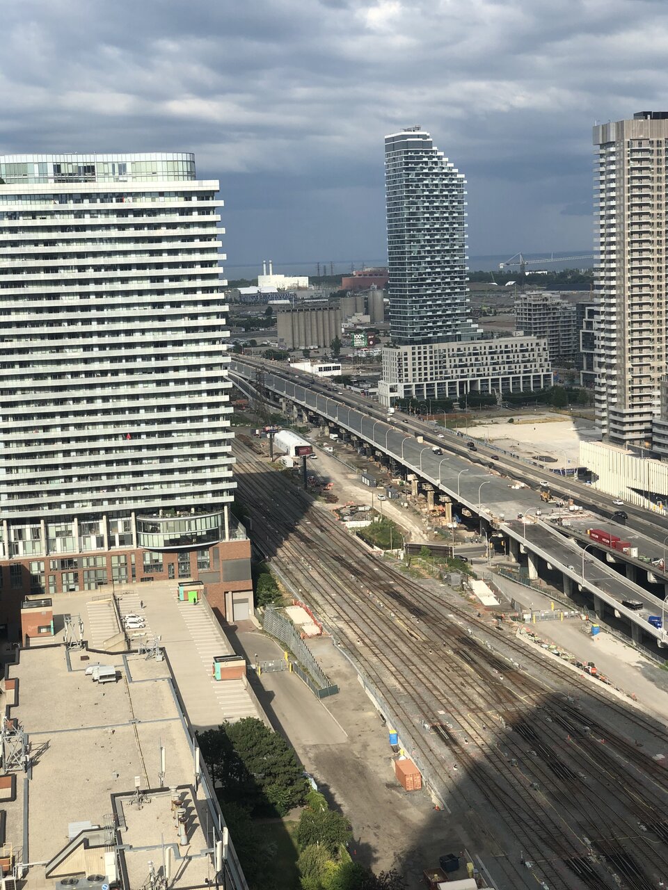

With all the deck sections replaced, all they have to do now is complete the north barrier wall and pave before traffic can shift to the opposite side and then rinse and repeat for replacing the entire south half of the Gardiner in this stretch.

Great pics. Thank you.
I believe that based on the schedule, the work on the North side should be completed within the next 3 months. The work on the South side should take less time and be completed by the end of 1st part of 2021. The Eastbound Jarvis on-ramp has been closed for construction as of last week allowing for concurrent work and faster completion of the South side.
Where did time go? Looks like they are ready for paving the north side. Wow 2 months!

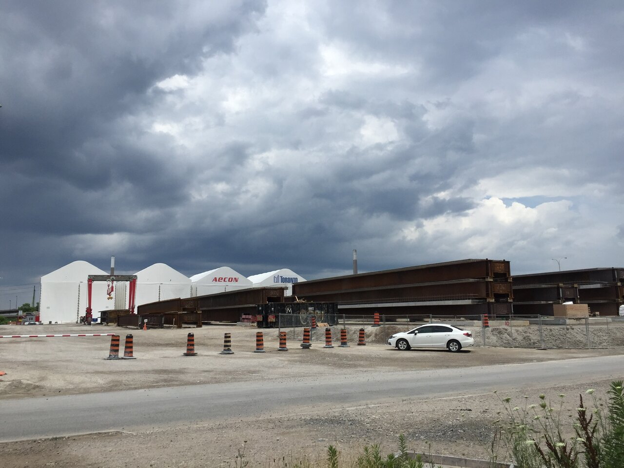

Prefab Gardiner parts being built, picture taken from the Lower Don Trail
