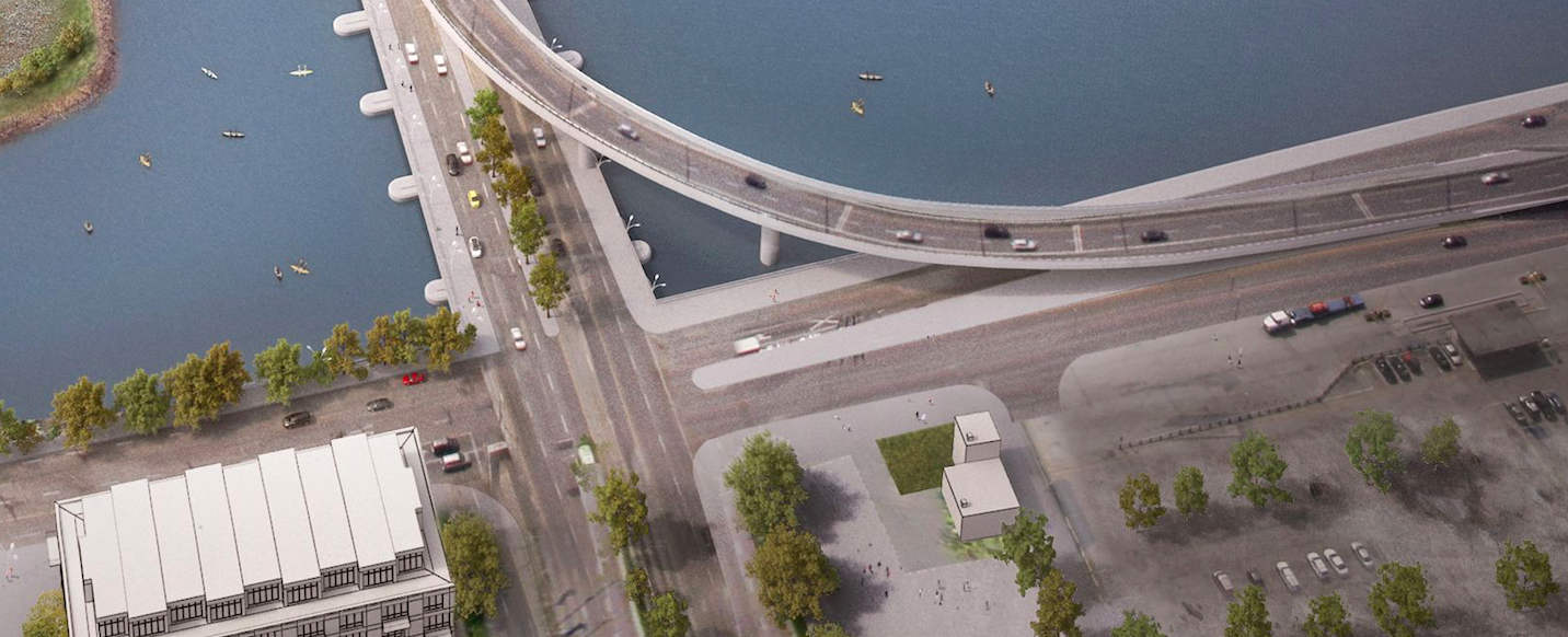

Why would this area of Toronto be any less nice than other areas?
Look again eagle eyes. No it doesn't.
Now I see where you got that impression. Something went badly wrong in that rendering - I guess they were working in a hurry. If you look carefully it seems to be two lanes one direction at the DVP end and 4 lanes 2 directions on the Lakeshore. Magic! I suspect it got cut and pasted from somewhere else.
By "No DVP/Gardiner direct expressway connection" they apparently mean that the Gardiner would end about Church and the DVP would start just before the Don, with a boulevard connection. But I see, given the wonky rendering, how it could be misread.

It's often been observed that the road supports along the Keating Channel all in a row are rather stately, and the hybrid rendering seen from across the channel confirms this. Keep a few, build an orangerie out of them, and sip drinks among the citrus.
