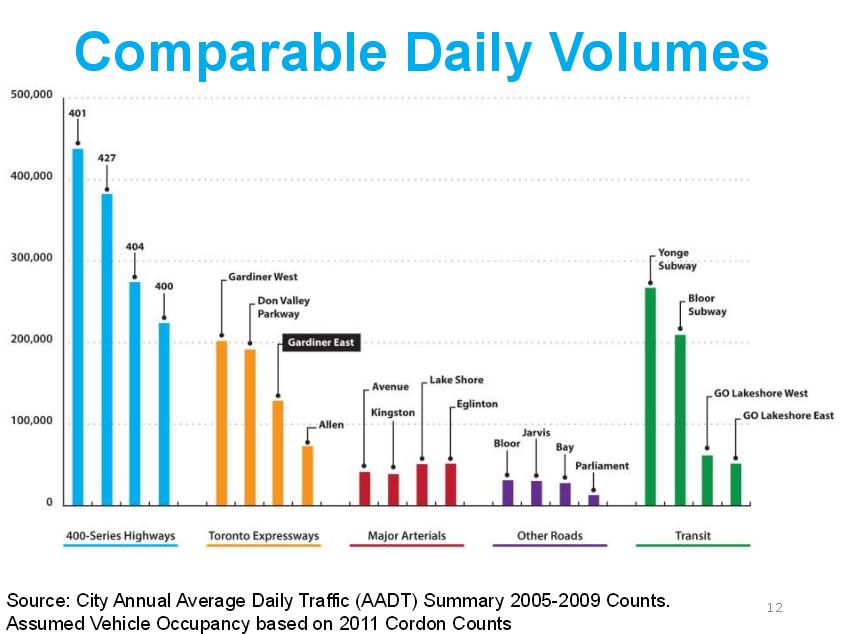

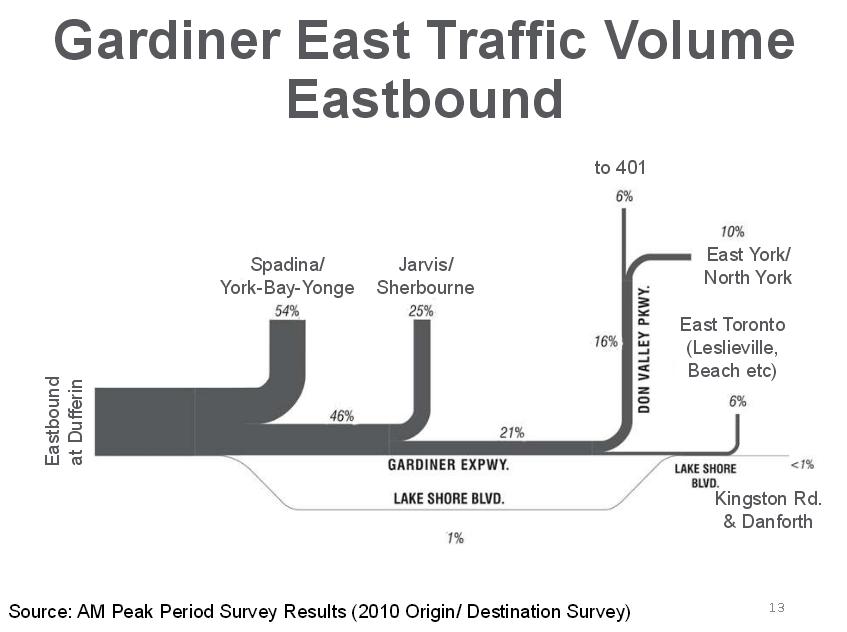

I don't disagree with much of what you have wrote, but it should be realized that the primary function of the east Gardiner is to move vehicles across downtown and not into the downtown core.
No, that's not the primary function. Around 80% of Gardiner east traffic exits at downtown.
It pains me to see how deluded some people are when trying to analyze traffic matters.
Kinda like your dump truck rant, or the silly Burlington Skyway analogy from yesterday. The options have been studied to death, the facts are out there, and the boulevard has been endorsed by every city planner, transportation experts, urbanists, and many other respected individuals. But go ahead and ignore the facts, keep pretending you know better than them. Why trust their computer models when you have your own logic instead.

In planning its capacity, yes. But there's more to transportation planning than capacity. I'm not doubting that the East Gardiner is overbuilt, I'm more trying to point out the importance of grade-separated systems (whether road or rail).
I'd like to see the cost of those subway delays you see everyday on the yonge line. How much time is lost on a daily basis from the bunching and short turning of streetcars. What do you say to those people who regularly can't get on a bus because it was too crowded, and waited almost 15 minutes for the next one. As a transit user, I can say that not only do these problems cost me far more time than the two minutes that drivers are asked to accept in exchange for a more beautiful waterfront for everyone, but it affects orders of magnitude more people than the 3% who use the Gardiner. This whole hoopla about the 2 minutes that affects such a minority of people is the epitome of driver entitlement, as if only their time is important. As if 2 minutes is everything. As if we have no choice but to unnecessarily spend so much money propping up the gardiner for their benefit when there are much bigger problems to deal with elsewhere. You drivers are so adamant that those 2 minutes "not be ignored" at all costs, while transit has been notably absent from the whole debate in city hall. DMW summed it up best: "these are not real people".
Correction: 80% of Gardiner West exits to downtown in one AM peak hour.
You can see how that figure can be misleading by looking at the total volumes. Gardiner east carries about 60% of the traffic as Gardiner west, which is still a very significant number.
The hybrid/remove options have barely been studied at all, hence why the only info anyone can find is from a powerpoint presentation consisting mostly of pretty rendering drawings. Personally I endorse the removal, I'm just pointing out that a lot of the "Remove" talking points are based on faulty assumptions. Such as the proposed additional delay times assuming four major transit improvements will already be in place:
