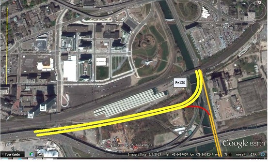

I thought about the real "hybrid" solution for the Gardiner. It looks like it would have a 90m radius curve - good for 50 km/hr. I also elimnated the DVP south to Don Roadway ramp because it would not fit under the Gardiner EB to DVP NB ramp. Somehow this would have to be put in, but not sure where.

The big question is whether the Gardiner to DVP is a continuous highway - in which case the design speed should stay 90 km/h, or is this a ramp from one freeway to another - where posted speeds of 40 or 50 km/h are not uncommon (400SB to 401WB, DVP NB to 401 EB, DVP NB to 401 WB, 404 SB to 401 WB).
PS. I sketched it with a 130m radius (a 60 km/h) design speed and it looks better - a bit farther from the railway but still plenty far from Keeting Channel. I still haven't figures out how to get a DVP southbound off-ramp. Any ideas??

I was doing some browsing and found that someone else had proposed the DVP to Gardiner ramp over the Rail bridge. However, they had the underground option, which requires the road to take 400m or so to get underground and then another 600m or so to match the elevation of the existing. I always said the burried Gardiner would only have a chance if a longer poriton was considered.
It looks like whoever put together the "hybrid" option did not do their homework. A true hybrid is supposed to take the best parts of the other plans.

Here's a crazy idea. Run the Gardiner straight into the DVP/Don Roadway and put a big European-style roundabout there. North leg to DVP, west leg to Gardiner, south leg to Don Roadway and east leg to a new road into Lever site.
