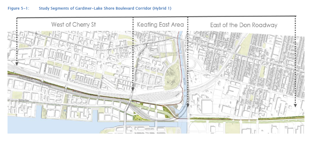

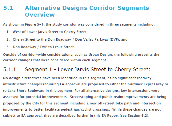

From the EA Final Report, Chapter 5 Design Alternatives
http://www.gardinereast.ca/sites/default/files//documents/Gardiner EA Report - CH 5 FINAL.pdf

That's replace - which isn't the option selected by council. And I don't think we selected "improve" either in the first four choices (maintain/improve/rebuild/remove) offered in the original EA. What council have chosen is basically maintain plus hybrid east of Cherry. Section 4.4.3.2 Hybrid Alternative (p. 96) offers no indication of changes west of Cherry either.

I have seen that too - the ramp from DVP to Gardiner is two lane - it's silent on the section past Cherry. Plus this still have to accommodate ramps to/from Lakeshore.
