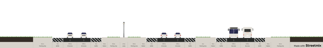

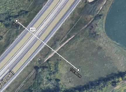

Anyone else think the ROW is a little big (170m!)? Even with a 70m ROW they should still be able to fit 6+2 transit lanes just fine with room to spare.
Anyone else think the 110m(!) ROW is a little big? Even with a 70m ROW they should still be able to fit 6+2 transit lanes just fine with room to spare.

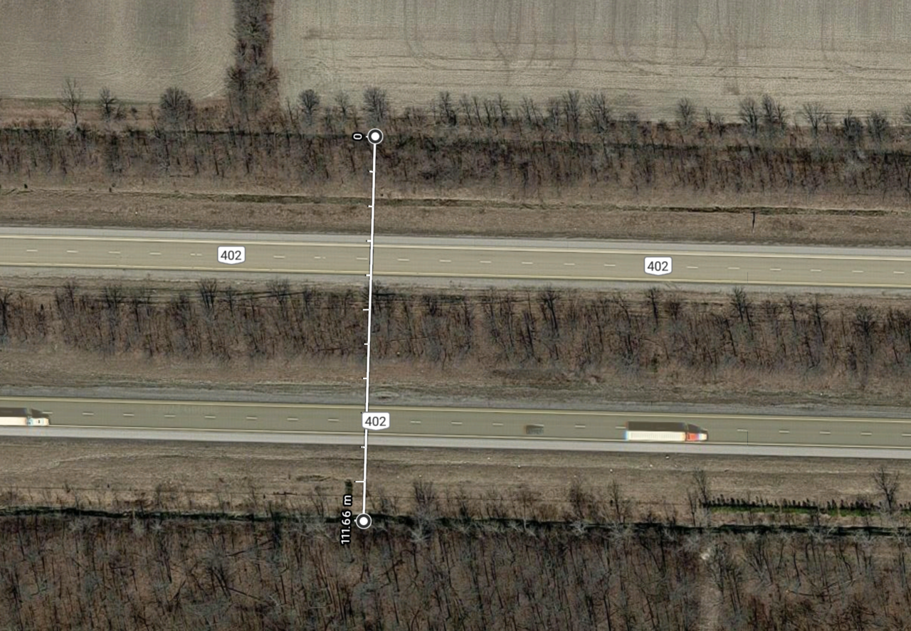

I do. I think it's an absurdity. But how else will they perpetually expand it in the future when traffic isn't alleviated? Sorry to be glib, but I just find this whole process to be depressingly regressive.

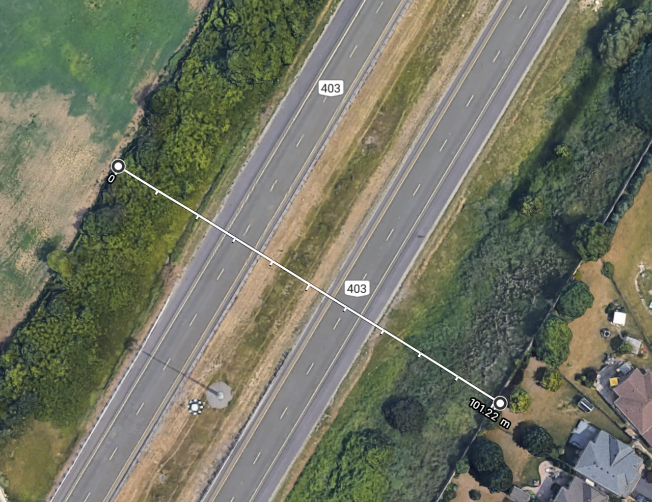

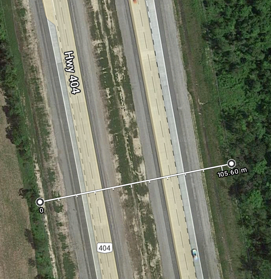

While this is true, these widths include wide medians and tons of empty space on either side (there does need to be some space for a clear zone but those are literally half the ROW in some of your examples). Also don't forget the transitway is an extra 60m on top of what you are showing.
A smaller highway footprint would not only be better for the areas the highway goes through by causing less damage and less "dead zones" when areas around it are developed, and it would also surely be more cost effective.

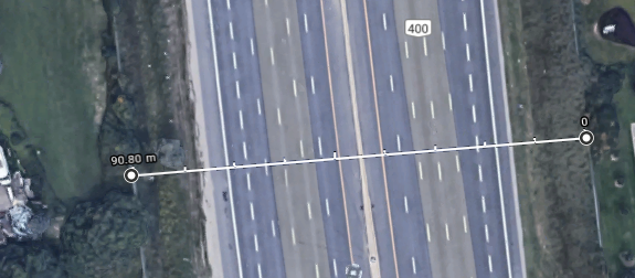

If 12 lanes can fit in 90m, then 6 lanes + transitway definitely does not need 170m:

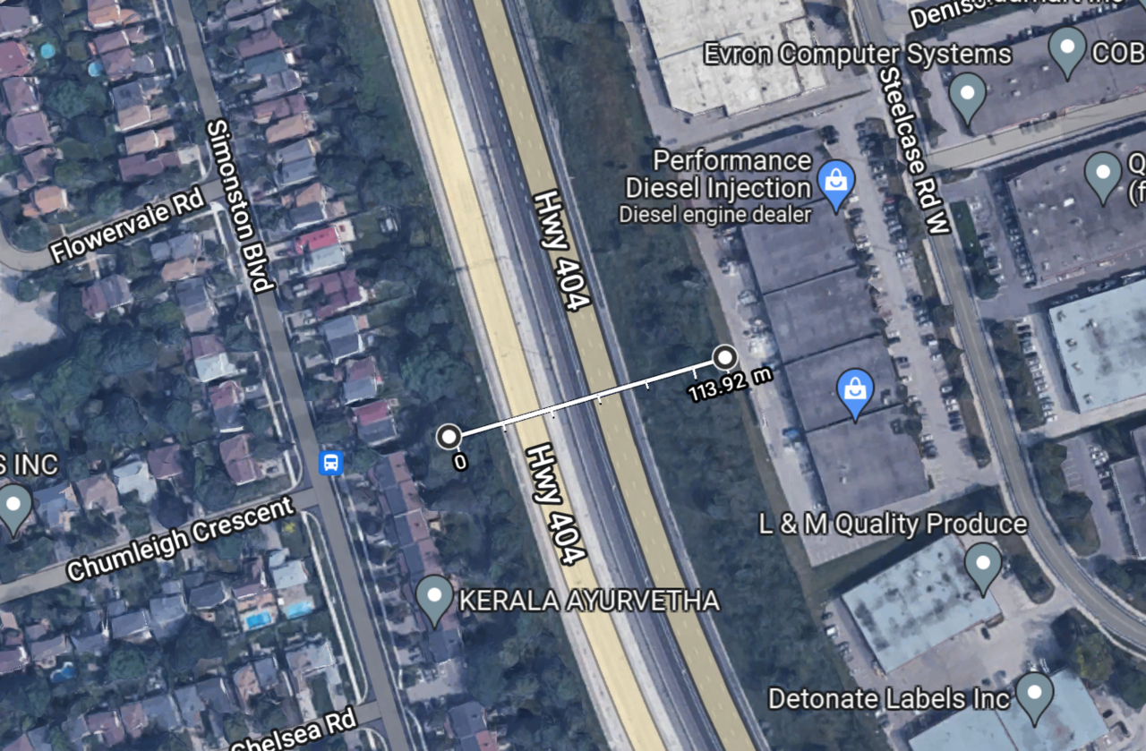

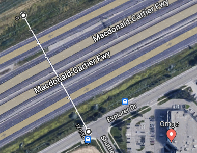

For reference on how big 170m is, here's the widest freeway in NA with 18 lanes and 4 carriageways:

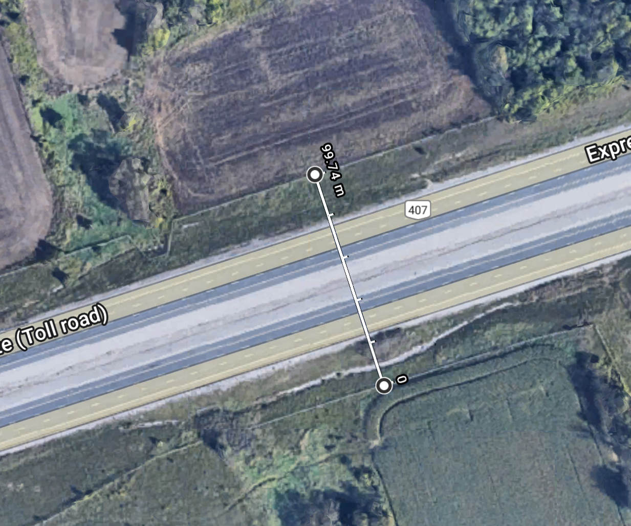

And compared to a rural section of the 407:

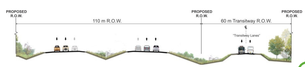

The transitway protection is what requires such a crazy ROW. You can see from the drawing that MTO would only need a 110m ROW for the freeway.
MTO's standard freeway design is to allow them to be widened to 10 lanes ultimately typically. So it's not just a 6-lane freeway with a 2-lane Transitway.
The transitway protection is almost overkill on this corridor if you ask me, I mean look at the 407, 30 years later there still aren't concrete plans to actually built the transitway through a dense area, and if anything the transitway may get scrapped in favour of a new GO Line according to regional transit planning documents.
407E, 427 extension, etc. all have transitway provisions as well.
The transitway portion of the ROW will sit more or less naturalized until it is needed at least, and will be mostly undisturbed by construction. Often times MTO leases the right of way to adjacent farmers as well in the interim from what I remember. They just simply ensure the land is actually owned by them.
