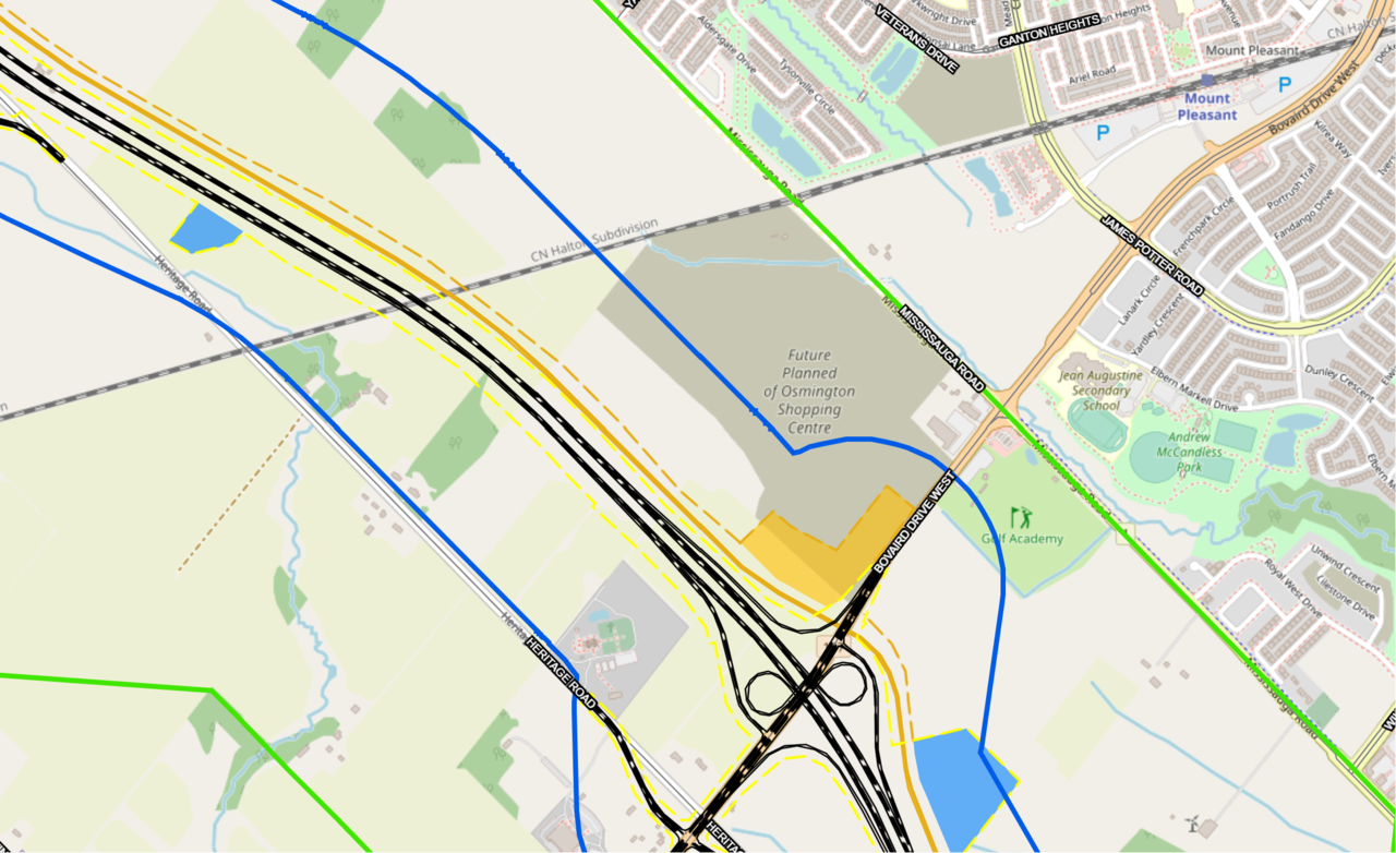

I notice that they propose a station at Bovaird Dr / 413, and not at City of Brampton's preferred location, which is the intersection between the Kitchener Line and the the 413 Transit Way. Perhaps it's the Province's way of say you're not getting that Heritage Road GO Station?
The MTO has been adamant that Brampton's Boulevard idea is the very definition of insanity, and as such they will completely disregard it. This does not preclude a Heritage Road GO Station. A Bovaird Transitway location will support Brampton's future Bovaird BRT.

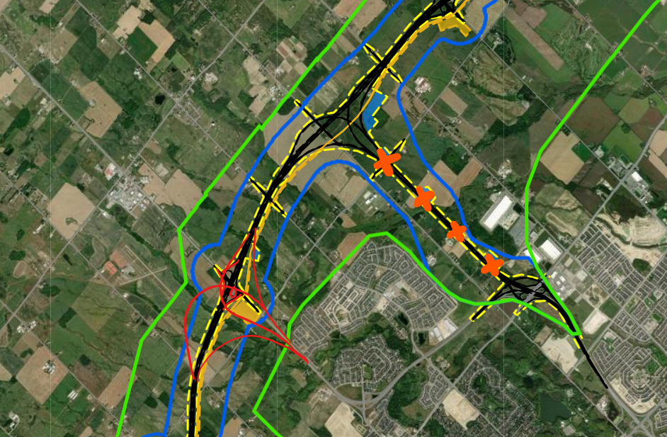

Long time lurker, first post.
- The size of the 410/413 interchange strikes me as rather excessive
I continue to be confused as to why they are proposing to retain the 410 connection to Highway 10, including expensive flyovers to connect it to the now extended 410, which is effectively replaced by the 413. I feel like they would be better off removing it as most traffic will likely get on the 413 anyway.
They could extend the 410 by about 500m, and use a combination of a Parclo A4 and a full freeway interchange. Coming from the 410 or going onto the 410 would use free flowing ramps, while traffic from 413EB to 10NB would turn left at a typical Parclo which is already what is proposed. Access from 10SB would be through the Parclo. I can't see any disadvantages, and there's no way it isn't more expensive than acquiring a whole new ROW and complicating the interchange with Mayfield.
I think the main reason why they want to build the new HWY 410 alignment is so it would potentially be easier to build an extension out to Orangeville in the future along a ROW clear of development. As it stands currently, HWY 10 goes through Caledon Village (which itself is surrounded by quarries on the south side), and some small towns, so converting it to a freeway would be difficult when the time comes. Just building something brand new 3 km to the east is much easier.
What confuses me, however, is why they want to maintain the old HWY 410/HWY 10 alignment as well.
the connection to Highway 410 is a really substandard design with an 80km/h speed limit on it - I understand MTO doesn't want to use it as the primary connection to the 413.
The question is why it's being maintained at all. It seems like it would be much better for MTO to simply build a direct flyover ramp onto Highway 10 at the 413 interchange.
The 410/413 interchange could still be a thing, but would only be a partial connection. It would connect 410 NB to 413 EB, and 413 WB to 410 SB. The other connections could be built as flyovers at the highway 10 interchange.
This is probably a better solution for now, and you could rework it a bit if you wanted to extend 410 further north. That future interchange wouldn't need to be as complicated because 2 connections already exist at highway 10.
Could those 80km/h curves be corrected at all on the existing 410 extension? I remember the 401 had it's curves reworked when it was widened from Woodstock to Kitchener, you could do the same here if you wanted to push 6 lanes through this stretch.
On a map at least, it doesn't seem like these curves are that different from the curves on the 407/401 (10 lanes) and 407/403 (6 lanes) where traffic handles them at full speed.
The curve as it meets Hurontario is a 525m curve - the modern standard on MTO mainlines for 100km/h posted speeds is a 900m curve. The 407 at the 401 is a 750m curve, which is the previous standard - you can tell if you have driven it that it sort of works, but is also sort of tight for a mainline freeway. the 407/403 curve is 675m, which is generally considered the minimum for a 100km/h posted speed limit, from my understanding. That one genuinely feels substandard when driving it.
There is a reason that stretch of the 410 has a reduced speed limit.
Also, using the existing alignment creates a lot of unnecessary travel distance for those travelling from the 410 to the eastbound 413 and vice-versa.
Looking at google earth, it would be possible to build a 750m curve on the existing 410 alignment, but you wouldn't have any space left for the Hurontario interchange without ripping out a bunch of houses.
At the end of the day MTO likely decided that the new alignment is easier - and I think that's the right call.
Not only is the existing 410 extension alignment to a much lower design speed, the layout does not really accommodate future widening beyond 2 lanes per direction. I wonder if the intention was to always treat this as a placeholder extension until 413 was built. And although this project leaves it as is for the most part, it could always be removed/downgraded following completion of 413 to a lesser road once Brampton/Peel/Caledon decide what they want with it.
I would think it would just be tacked on as part of Hwy 10. It would be strange to have Brampton or Caledon (keep in mind Peel will soon cease to exist) manage a road that solely connects two provincial highways.
