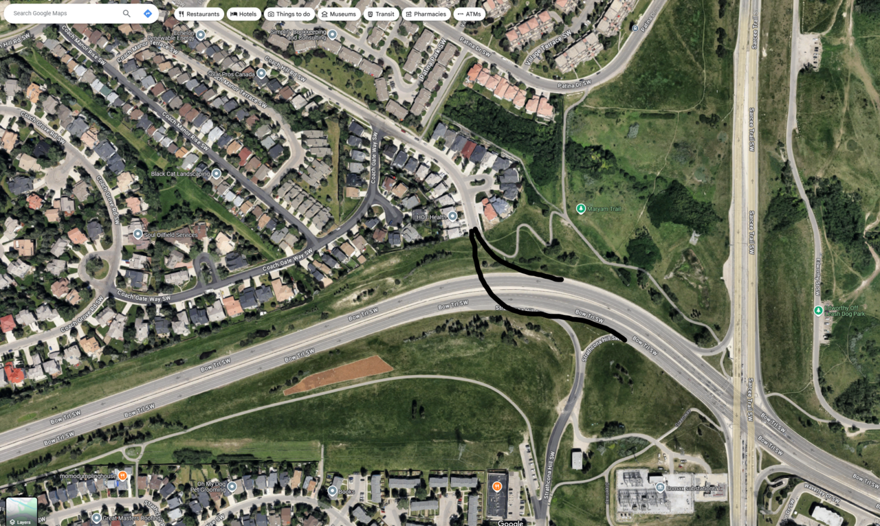

I know I'm on the wrong thread...but a cheaper alterative would be to implement MAX service BRT from West District to Downtown. With a few tweaks in the road network, the city could move more people, more efficiently to downtown.
Build a bus-only westbound off-ramp from Bow Trail to Coach Hill Road and build a bus-only eastbound flyover from Coach Hill Rd, to Bow Trail.
Connect these roads and build an intersection for Buses.

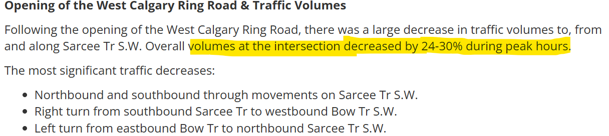

That's the part that I don't get - they open with this saying traffic volumes are down 24 - 30% during rush-hour thanks to the Ring Road.
The action as a result of this fact... we need to prepared to build more car capacity and an interchange? The data referenced (but not provided) should point to the opposite conclusion - Forgetting all the real trade-offs about park space and land consumption. How can we get to the conclusion we need an interchange when traffic volumes have collapsed?

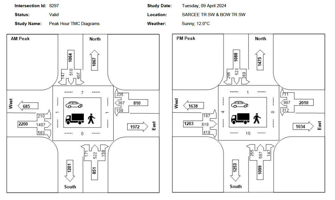

Looking at the last traffic study, and having driving through there hundreds of times, the trouble is the length of the full cycle with every phase, and there is an easier way to 'buy' more time than the interchanges they designed. If it is still congesting,
Diverting east-west traffic entirely to a bridge removes 45% of capacity demand (phase time demand) from the intersection at PM peak, and 55% of capacity demand during the AM peak. A single lane each way would be enough, but would likely cause bunching at either end, so a 4 lane bridge would be built instead.

I think Bow Trail did increase in volume, though. It serves a lot of traffic to/from Stoney Trail, now. They probably couldn't make the green light phases for Bow Trail any longer than they already are.
