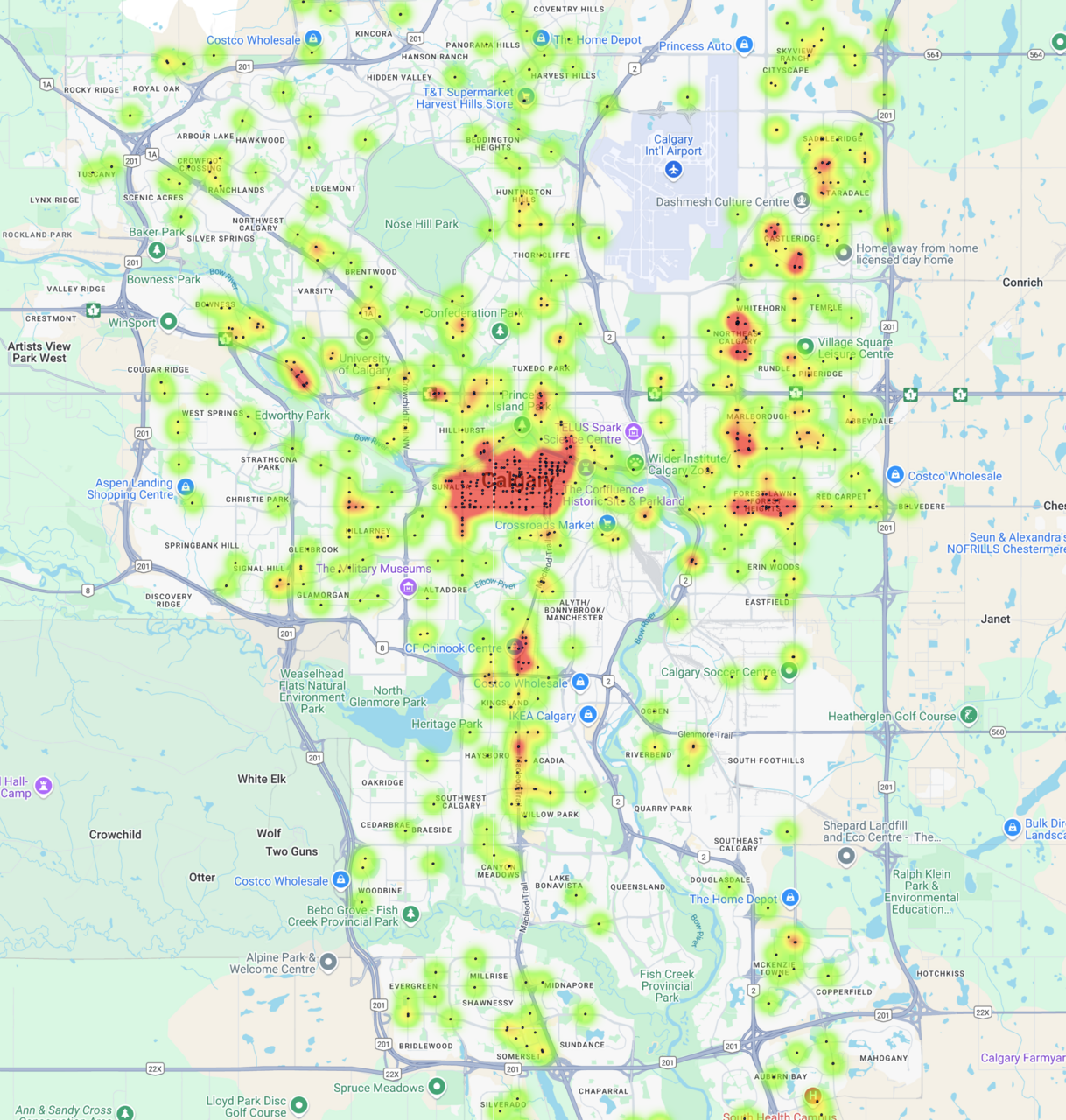

View attachment 615800\
The above is a map of every place a driver has sent a walking Calgarian to the hospital in the past 3 years. Unsurprisingly, downtown is the major hotspot.
The thing is, you can't just focus on improving walkability where people are getting hit. You'll notice that the areas with the least amount of incidents are also the least walkable.
When things are so dangerous for pedestrians, people just don't feel safe being outside of their car.

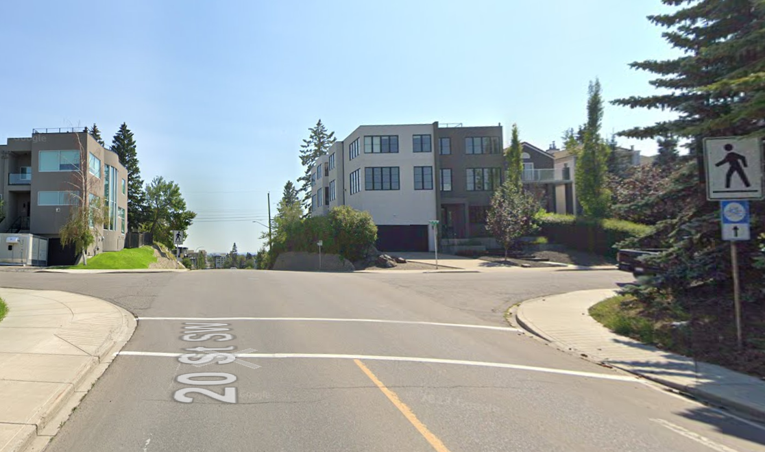

This article was a wild ride of emotions... I'll concentrate on 20th, as its a street I know well since I live in the area. I get that the road design is the issue because it allows cars to drive to 50km/hr. And maybe him mentioning the fact that there are no traffic calming measure in place means they will install some but probably not.
So, if there are no traffic calming measures how can you expect speed to be reduced to a safe level?
Also what could you actually implement to calm traffic here?
