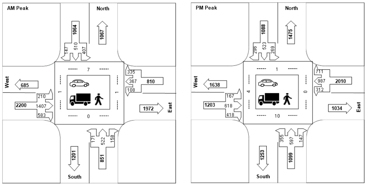

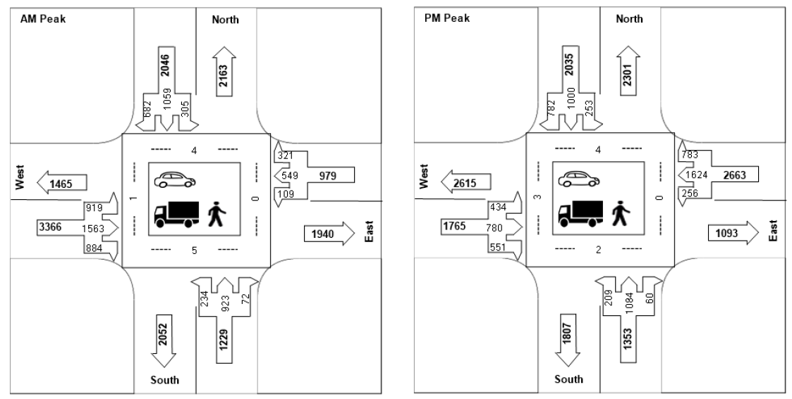

HUGE drops.
Pre Stoney (November 2022):
Post Stoney (April 2024):
Nice find - that changes my opinion. When you see drops in volumes at Bow/Sarcee to such an extent, it strikes me as a reason to push this one off by 30 years rather than request it now.

This shows most of the significant inputs and outputs down like 30-50%. The EB-NB turn movement dropped from 919 to 210 in the AM! (and 434 to 167 in the PM). The other three PM left turn movements increased slightly, but negligible changes in the AM.
The only real constant is EB Bow Tr in the AM. So you can make a bit of an argument for the extra lane there, but it's still the epitome of one more lane, bro! Bow Tr streetscape could use work one way or the other, and the new Edworthy access would be good, especially in conjunction with Spruce Dr improvements.
