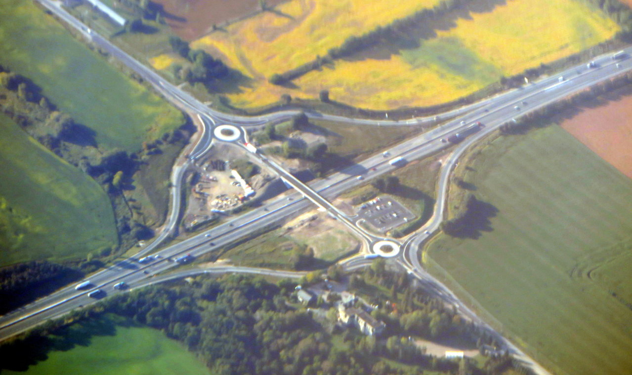

New "dumbbell" interchange at Highway 401/Highway 19 in Ingersoll. It replaces a regular diamond interchange that was modified from the cloverleaf originally built.
The first, I believe, in Ontario, though there are a few in Quebec.

That’s a much smarter design than having two lights over a highway. With this traffic is slowed but doesn’t have to stop most of the time.

7th Street just west of St. Catharines has a slightly different version. Interesting, they took out the NB to WB (Toronto Bound) and SB to EB ramps and force them 270 degrees through the roundabout. It might make some sense on the EB ramp, since it maybe removes some of the lane transfers close to the 406 ramps.
https://www.google.ca/maps/@43.1796469,-79.3077925,974m/data=!3m1!1e3
The old NB-EB on-ramp was a bit deceiving because although it started out like a regular on-ramp, it did a very, somewhat unexpected, sharp turn. They've moved this turn into part of the roundabout, which, by it's nature, forces people to slow naturally.
