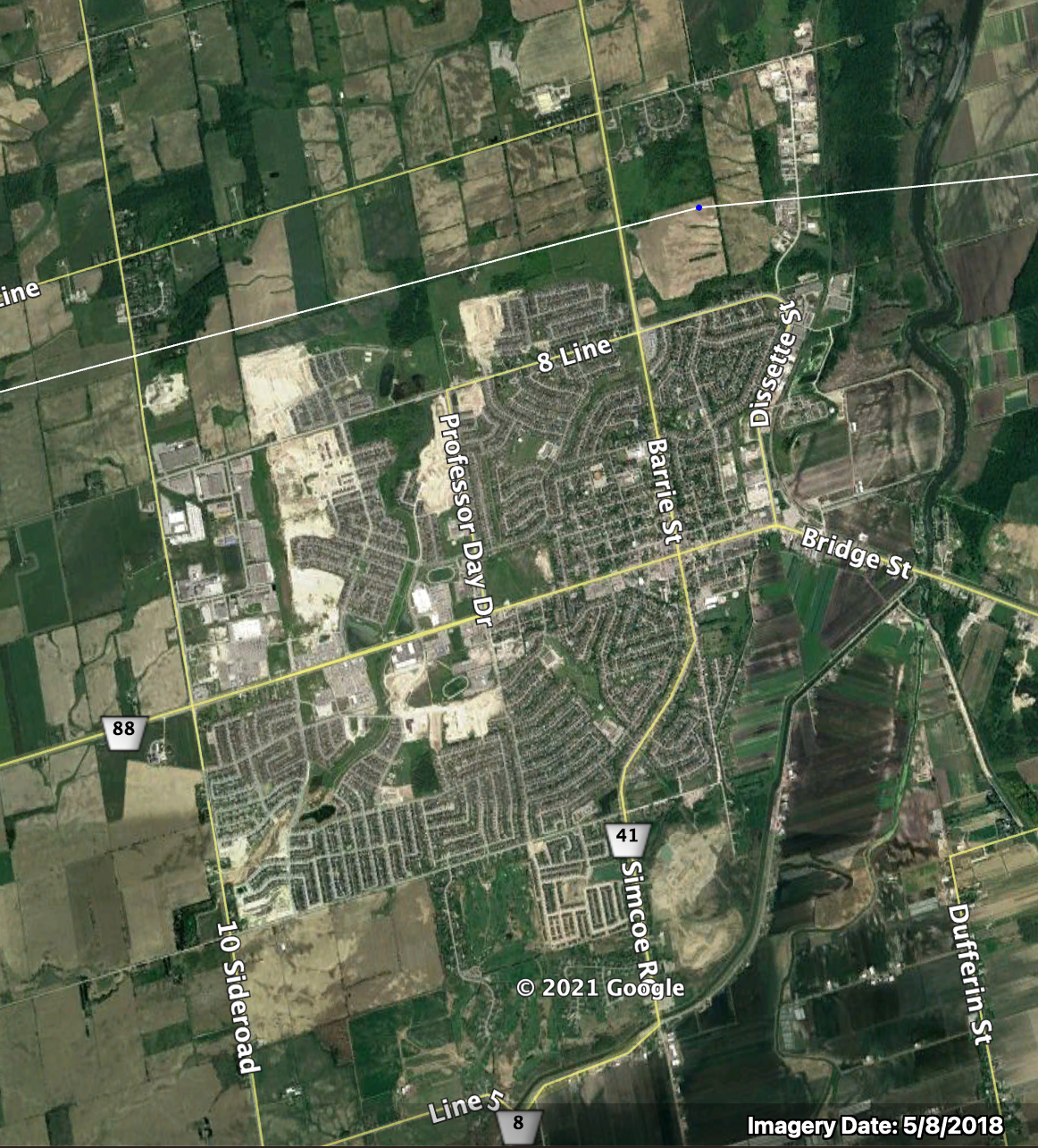

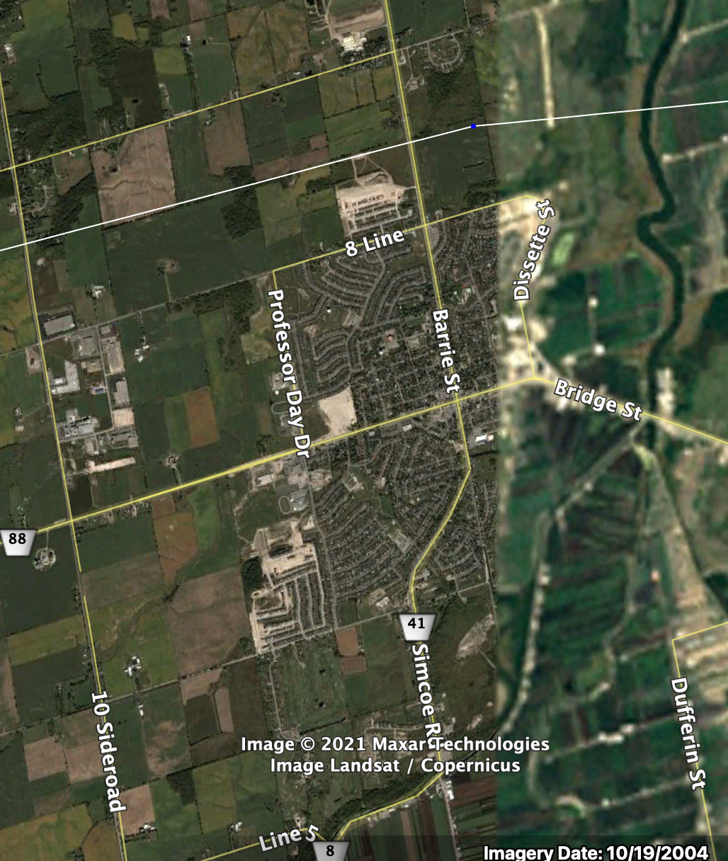

Anyone with Google Earth historical views of the area can see that...
Not exactly the same scale, but you can see my point! 2004 versus 2018, with a rough line of the highway.
Move the road slightly further north from the residential area by County Road 4/Yonge St, to allow for more space for mitigation landscaping/noise walls to reduce road noise/air pollution/light spill to the residential area (neither residential development was present when the 2002 EA was published)
The highway will likely be bermed or landscaped anyway. Not a big deal.

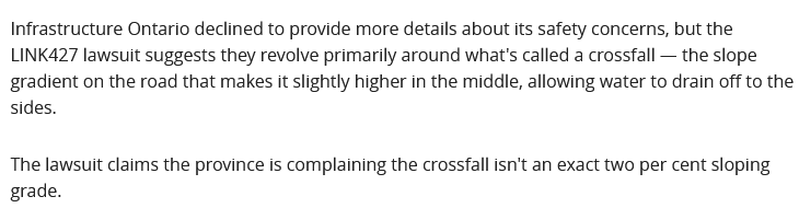

Another report on the 427 debacle, this time from CBC:
Here we seem to get to the meat of the issue:
I don't know that I've read an MTO P3 contract in detail to see what's in the standard language..........
But the 2% crossfall is a pretty standard design.
There are no drains in the middle lane of a 400-series highway.
The water needs to go off to the sides (or one side) and to do that you need a certain gradient.
^ That sounds like an expensive fix?
If it's only off by bit (half a degree or less) they can fix it by stripping the asphalt and relaying with varying thickness (~7cm thicker in the middle; I presume the crossfall is too shallow).
The legal argument is far more interesting. The Province says the requirement was in the contract and the consortium says it wasn't; that seems like it should be an extremely short court trials. Either the province can point out the clause (in the contract, referenced material like building code, or it can't).
