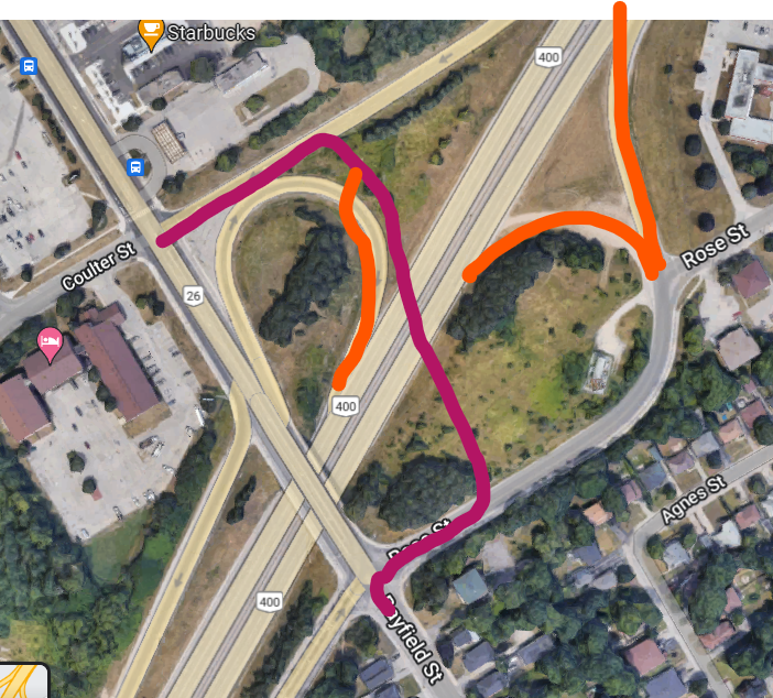

It's doable, if you use Rose St a bit and meander Bayfield through the interchange on a temporary bridge. The old loop ramp can also be used temporarily
"Doable" perhaps, but then they would be into the 'build-two-bridges; tear-down-one' which was the original question. I'm not sure they will do that but don't really know. It would certainly disrupt flow and some of the suggested angles and clearances would be very tight. It would also likely cost the eb/sb ramp, and the n/b ramp/Rose St. intersection is right at the bridge for construction purposes.
When you consider the gradients and spans involved, traffic loads and a whole host of other engineering and liability factors, I don't think the concept of 'temporary bridge' is realistic but, again, who knows.

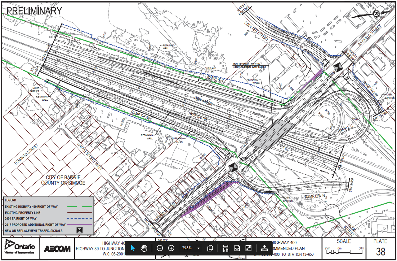

I looked up the plans - see below. Basically all the houses on the east side of Bayfield south of the 400 are going to go bye-bye. Even with the expropriation though, it still looks like it's going to be a fairly complex replacement process with half of the new bridge built first, traffic shifted onto it, then the remaining half built, as it still partially overlaps with the existing bridge. The Shell gas station on the north side of the 400 is also getting expropriated.
Dunlop has just as much if not more expropriation as well, taking out several plazas around the interchange.
Thanks for that. It's going to be a tight job and, as I suspected, no major re-alignment of Bayfield to accommodate a new bridge while the existing is still in service. Bayfield is fairly jammed at the best of time, especially in the summer, so it's going to be a place to avoid.
