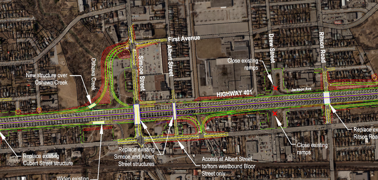

I have the design plates saved on my computer for it - MTO has done preliminary design to get the E-C to the 412, then a regular 10-lane cross section through the pinch point in Oshawa. It fits, but there is a bit of expropriation involved.
MTO is replacing the Simcoe St overpass and surrounding overpasses starting this year, and will be doing most of the expropriating for that project. So most of the expropriating has already been completed.
This is the widening plan for through central Oshawa - the red hatched areas are required property takes. The biggest impact is a row of houses on Jackson Ave east of Ritson to accommodate a new off-ramp. OUtside of this one central section, the highway widening more or less fits within the existing ROW. A few houses are needed in Ajax as well, maybe 10-15.
thanks for that. I was unaware of how far along the planning had come.
