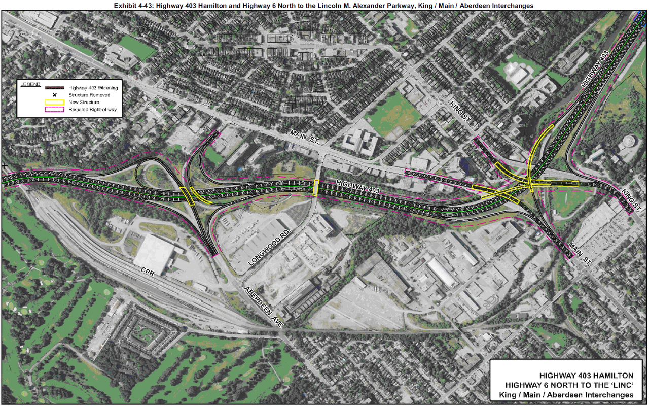

The report itself says that the intent is for it to be a 12-lane structure (2 additional lanes in each direction) like I suggested, but they drew it with 16 to "allow for long term expansion and construction staging in the future", apparently.

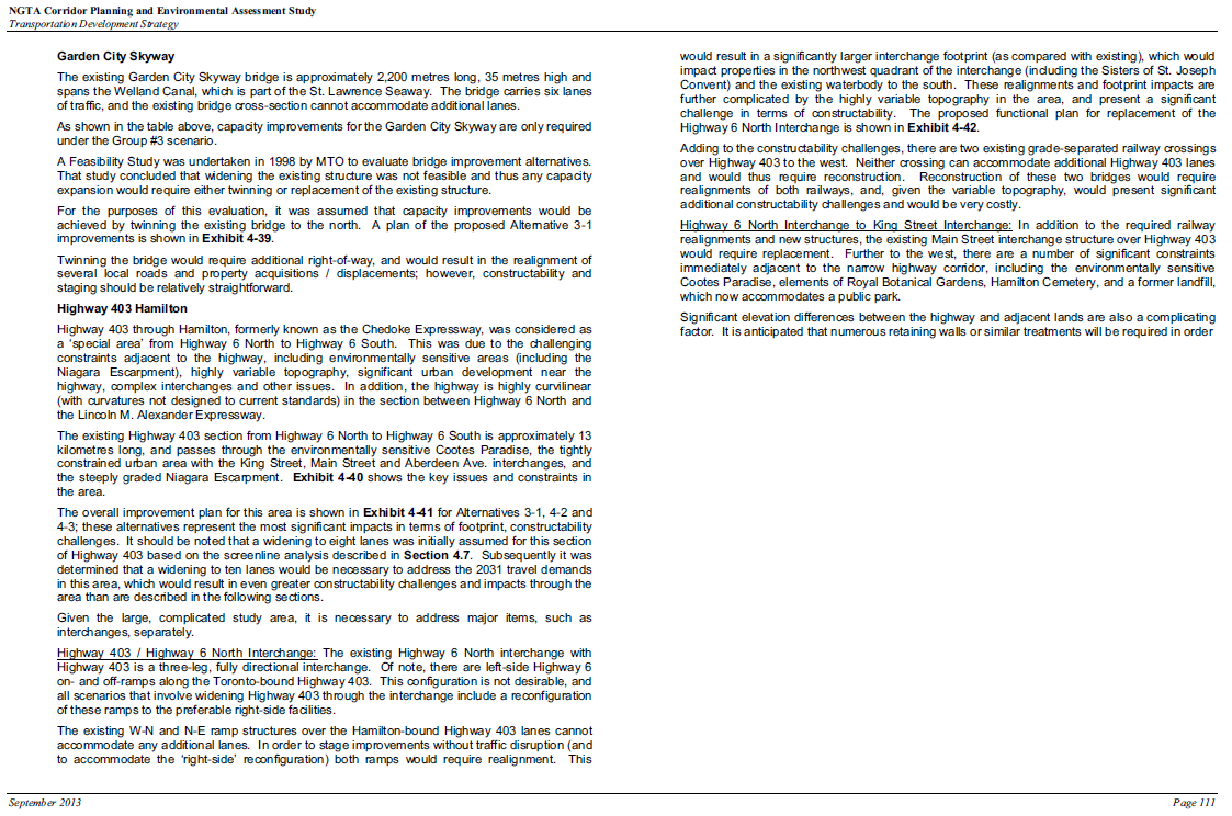

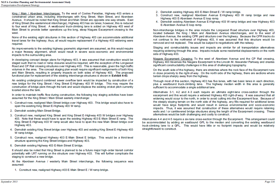

Regarding the 403 through Hamilton - The very same study looked at that as well:

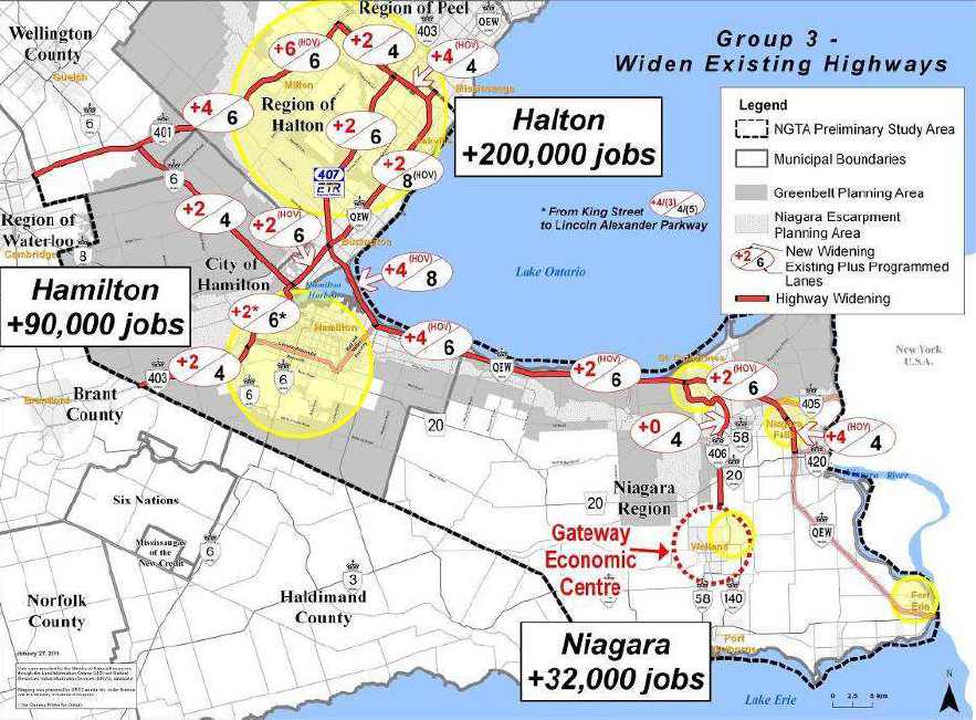

The same report also reviewed at a high level widening the 403 through Aldershot, the Freeman interchange, the 403/QEW interchange in Oakville, upgrading the RHVP / QEW interchange, and twinning the Garden City Skyway. several of these have since proceeded to full EAs and are even advancing to construction (Garden City Skyway twinning), including the 403/QEW Oakville interchange, Freeman Interchange, and 403 through Aldershot.
you can see all the long term lane widenings MTO has planned on this graphic - I will note that the 403 through Aldershot has since been changed to an additional general purpose lane, not a HOV.

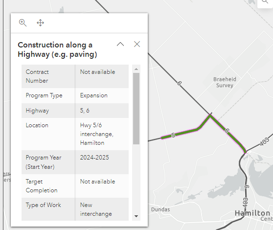

The Waterdown Bypass is a different project, a municipally led one. Every year it's happening "next year" so who knows when it will actually be built, but it's not an MTO Project.
The Highway 6 bypass is further north at the 401.
MTO Does have the Highway 5/6 interchange in Waterdown on their 5-year expansion plan list now, but it was only added last year so it's likely towards the end of the 5-yar schedule.
Ok thanks. That whole area has become so much busier, hwy 5 from Hwy 6 for miles east, and Hwy 6 from the 403 to the 401.
