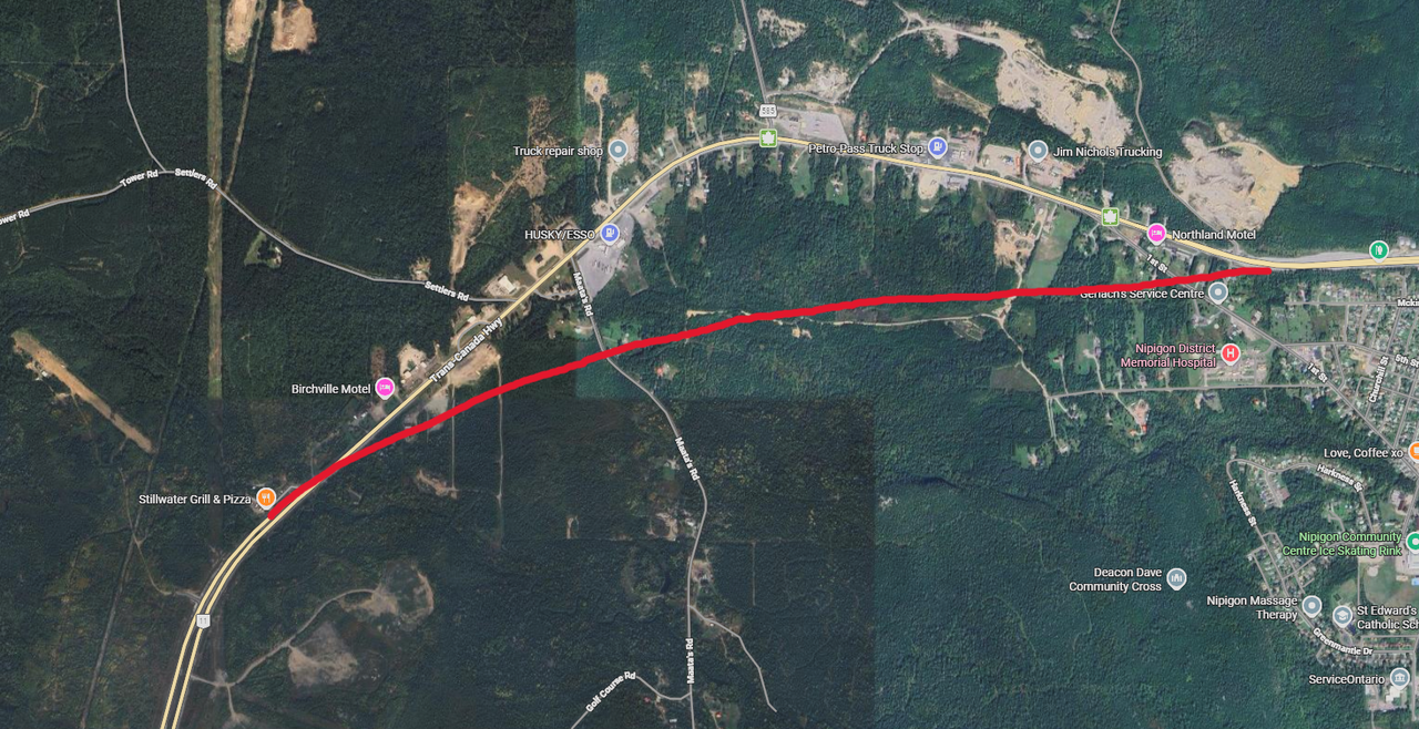

Preliminary design of 5.22km of HWY 11/17 widening from Stillwater Creek to First Street in Nipigon, for delivery by March 2027.
This one is interesting, it seems like it is decently developed, at least by Northern Ontario standards. I wonder if they are planning on bypassing it entirely or just converting it into a 5 lane road.
While they could do something like this, I have to imagine that there might even be pushback from those businesses who want the traffic running by them.
Yes that is the plan.
This is the description of the contract:
Project Number: 6025-E-0029 - Preliminary Design Study for Hwy 11/17 from 1 km West of Stillwater Creek Easterly 5.22 km to 0.83 km East of First Street in the Township of Nipigon. The Study will include a review of the existing conditions along the existing and future Highway 11/17 corridor; and update the 1996 EA approved preliminary design plan (initial and ultimate) where necessary to address changes in conditions and current ministry standards and policies.
The highway is four-lane divided both west of there and approaching the Nipigon River bridge. That stretch currently has a number of highway-related and heavy truck businesses on it. If they tried to divide the same alignment it would create a lot of turning conflicts and require a lot of expropriation disruption. Better to turn it into a service road with access and both ends.
