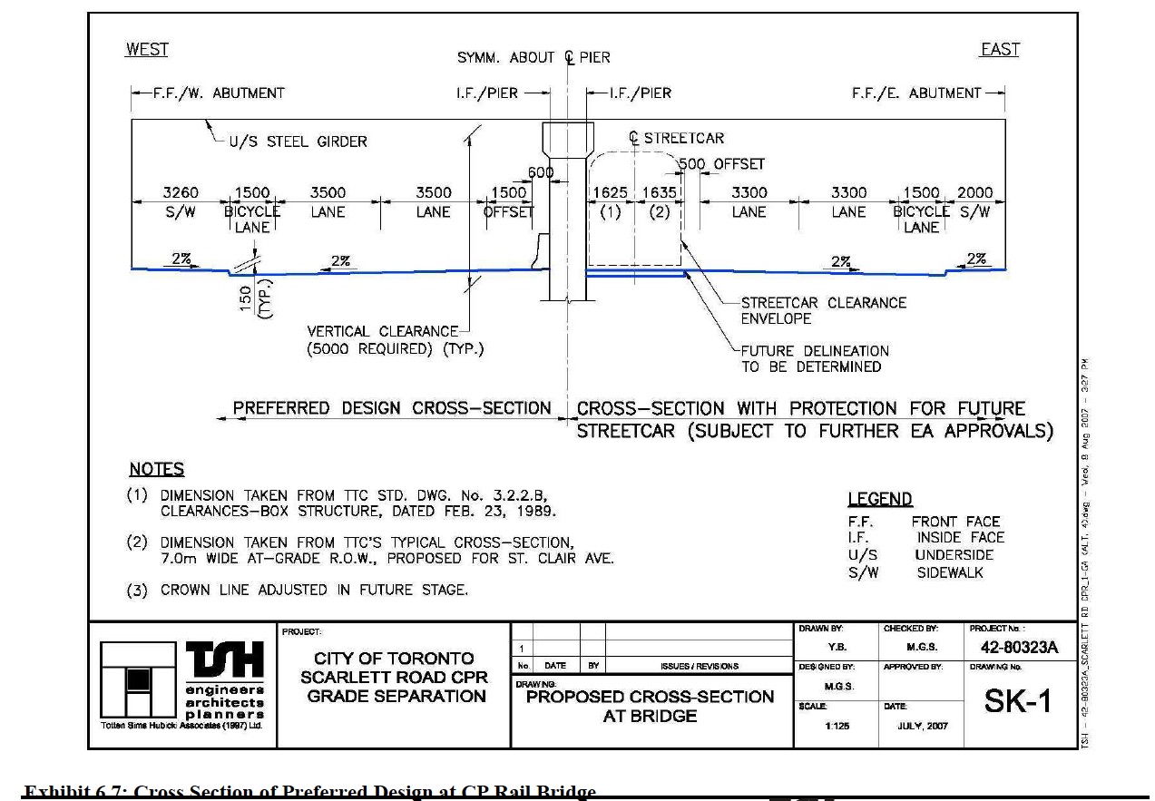

From the Environmental Study Report dated August, 2007 (see link):
I guess we'll see if things got altered over the ten years since the EA. Don't like the "subject to further EA approvals".

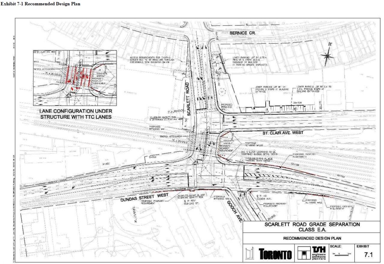

The recommended design from the ESR. Hopefully, the presentation will have a better representation.
