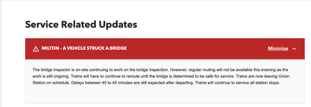

FWIW the bridge was struck by a truck today, forcing Milton GO trains to detour via the Canpa Sub. No info on how long the reroute will continue.
As of 21:45 this evening, CP freight is using the bridge, so I expect things have cleared.
Interesting to see the use of the Canpa Sub - it does happen, it seems.
