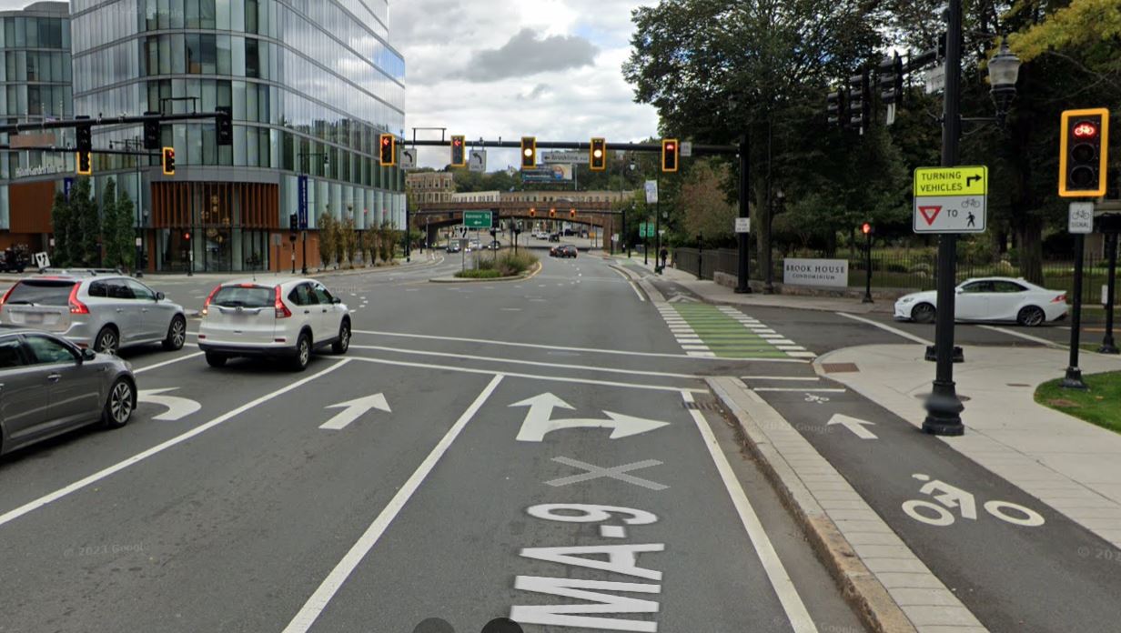

A more intuitive way of displaying this would be to have a right turn signal head with a red arrow, yellow arrow, flashing yellow arrow and green arrow, as is done in the US. But that's not currently permitted under the HTA (reg. 626) so the above example is the best we can do in Ontario.
An example in Massachussetts using red arrows and flashing yellow arrows:
