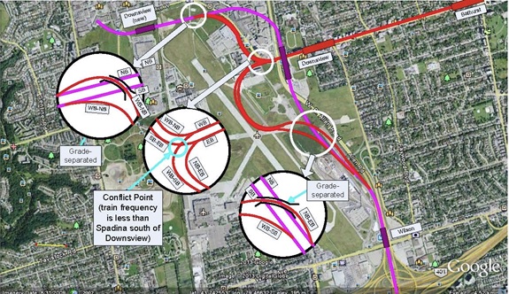

I haven't thought about interlining at Pape, but maybe for Sheppard.
There is more than 1 way to skin a cat. I imagined the Sheppard West Station on the Sheppard Line being somewhat away from the Sheppard West Station on the Spadina line. You are right that there is no need for actual transfers there. I would connect them by tunnel - sort of Spadina Station style transfer. Having the stations separated, makes for easier construction as a complex station does not have to be built under an active station. It's much easier to build a simple tunnel under a station. What I show has one conflict between WB to SB trains conflicting with SB to EB (which requires less frequent train movements than a conflict on the main Spadina portion). All others are grade-separated, and these would be built in the middle of a field, where there is ample room for construction.

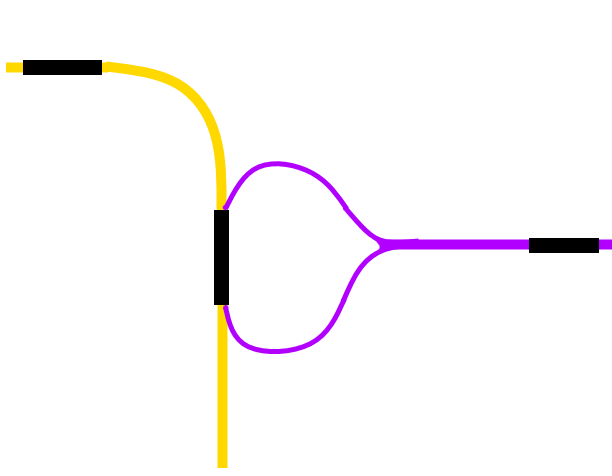

Is something like this possible?

Yes, but that purple circle will be big - maybe a kilometer.
Going WestBound, there is a (~45 degree) right curve with 300m radius minimum, followed by a (~135 degree) left curve. There is then a minimum 150m platform, followed by the same in reverse (135 degree and 45 degree curves) until you are now facing East Bound. Add to each of those distances some spirals (the gradual transition from a straight portion to a curve) and you are talking a pretty big circle.
