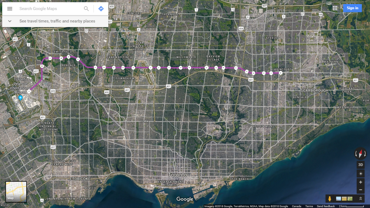

this is what my fantasy Sheppard extension
This is okay enough, but to critique a few points:
Instead of Pearson, have the western terminus be Westwood Mall. Too much redundant duplication to have it serve Pearson, whereas Westwood is a major hub. Serve Kipling/Albion directly for easy access to the Albion Centre and the Finch bus. Your line seems to deviate south along Westhumber.
Have the line follow the path of the SRT east of Agincourt. So a new Midland/Progress Stn, then SCC, Bellamy, Progress Campus, Milner Business Ct, Sheppard/Progress, Malvern Town Centre, Morningside/Old Finch then following the Seaton rail corridor terminates at the Zoo.
This winning alignment would serve over half a million residents across the northern 416, not to mention all the 905 commuters that commute down to such a line.
Taking a bus from the 905 to a line that’s not 1 or 2? That’s unheard of!
In the east I have a real problem with an alignment that sticks to the noeth. You're precluding Centennial College, Rouge Valley and UTSC station while making Pickering GO more of a challenge. My argument really would be for STC with the intention of an Ellesmere alignment for extensions, and this plays nicely with the Premier calling for a Pickering subway.
Mid you, given the choice I'd salvage the SRTs viaduct for this and build as LRT, with less than fully grade separation east of STC likely covering the cost of converting the Sheppard line.
Can Pickering Regional Rail or Pickering HRT work instead?
Pickering Rapid Transit would be my take since I'd really like to see light rail STC to Pickering. The above sound like what we're already getting on Lakeshore, which doesn't address what this (and the Pulse extension to STC) are trying to, namely that Durham absolutely has demand for reasonably speedy connections to points not downtown or directly on the Lakeshore line.
