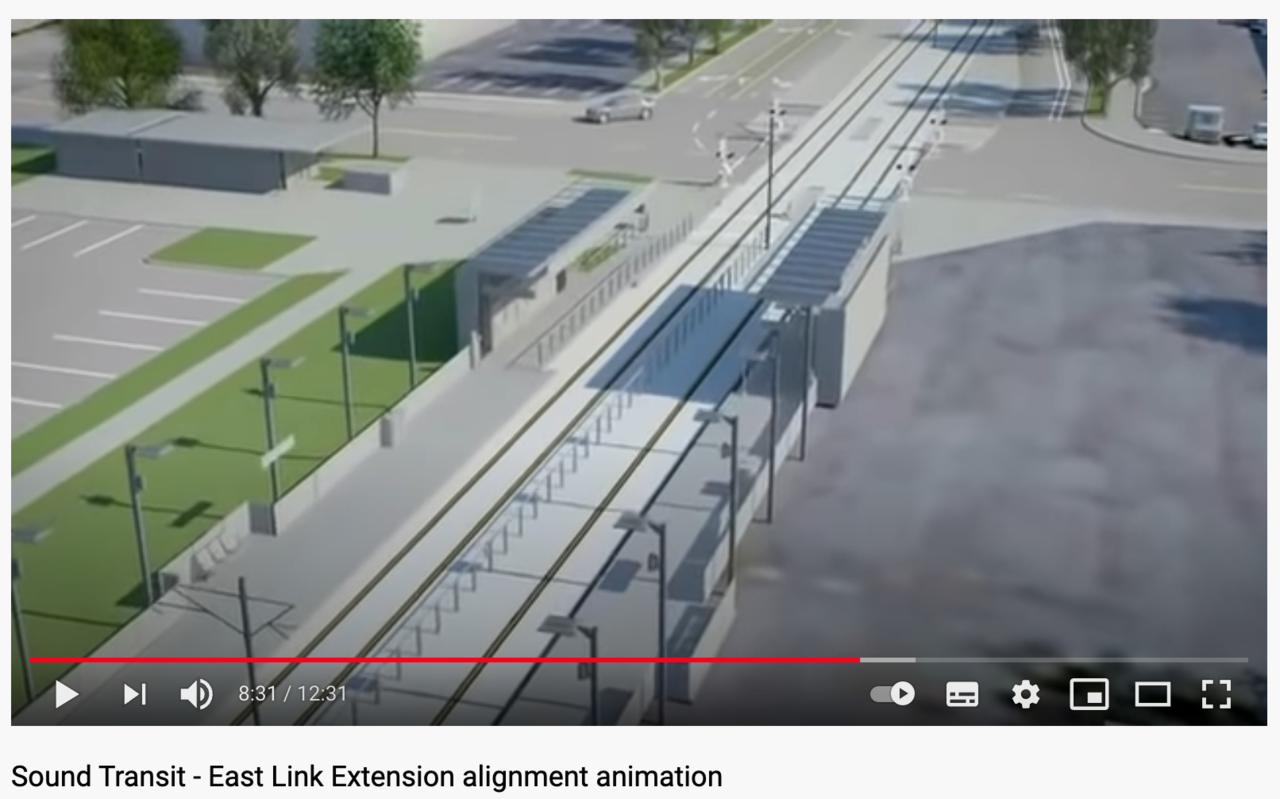

Second, the newer sections of the Link are being built in a way more comparable to the Vancouver Skytrain, elevated guideways mostly separated from traffic. The big difference though is with the exception of the Tacoma line (which isn't even connected to the main line yet), there aren't any sections of the line where the train stops at a traffic light. The entire line travels on its own right of way, and whenever it does cross the road at grade, its always with flashing gates meaning that unless there is a car crash or some other incident, you will NEVER stop for any reason other than you're at a station. Same exact thing with the Capital line in Edmonton. If you can't comprehend the difference, then I can't help you.

Seattle's LRT is more of an S-Bahn than any of the LRT projects in Toronto with the exception of Maybe Eglinton. There's far more grade separation.
Outside of one portion of the LRT network that was built in the first phase, it's entirely grade separated. It's more like Ottawa's LRT system in that it is more of a light metro system.
The Bellevue line specifically is fully grade separated from Downtown Seattle out to Redmond.
it was always funny to me that Olivia Chow used it as a prime example of LRT in her mayoral campaign, because it's quite a different type of LRT than what was proposed in Toronto at the time.
