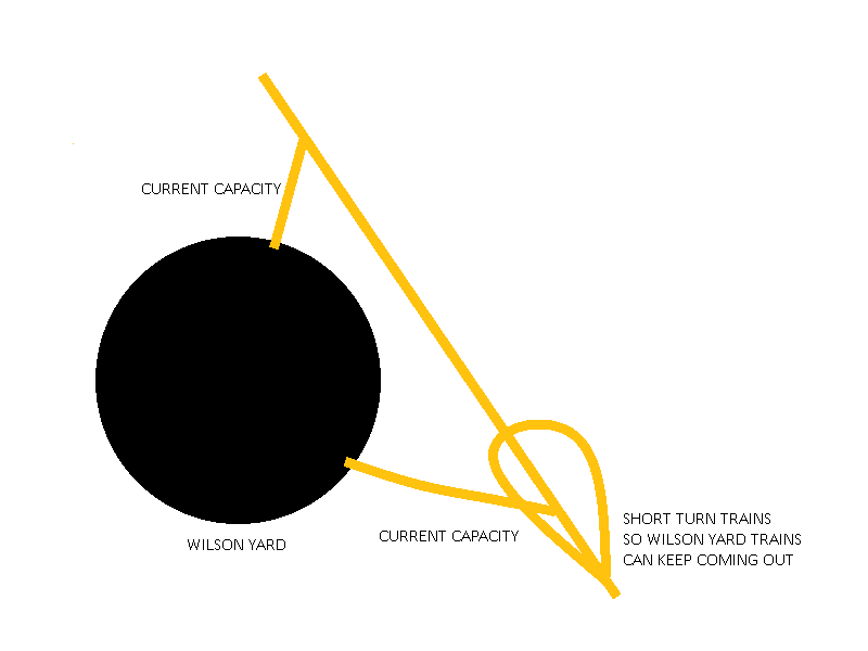

If I interpreted what you said correctly, you mean this?

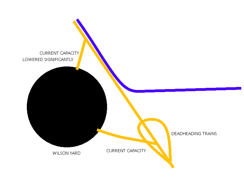

What you're saying with this interlining will happen is this?

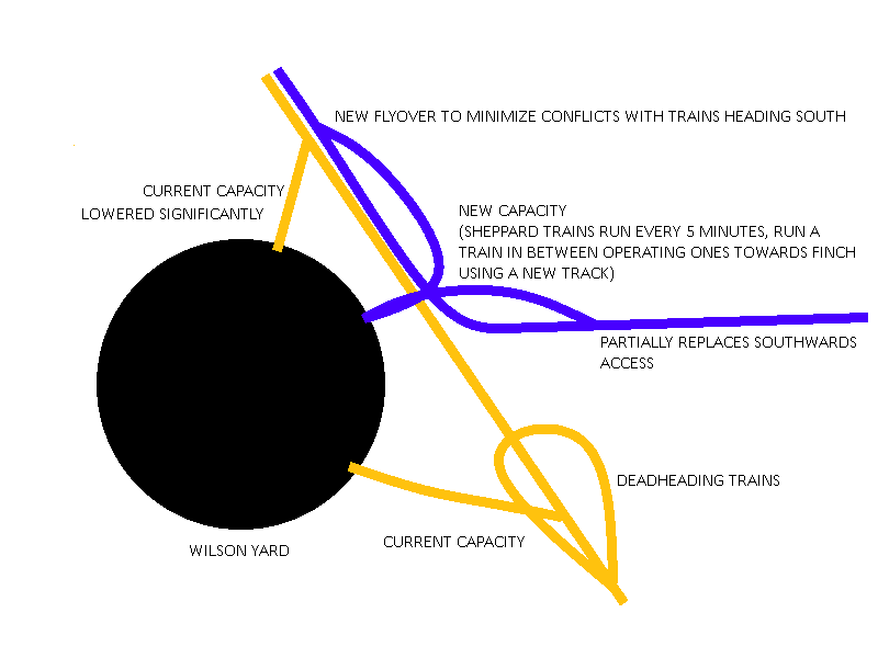

And what I'm proposing is this:
When I say "new track" I mean new access along with new track from eastbound Sheppard to Finch, maybe.

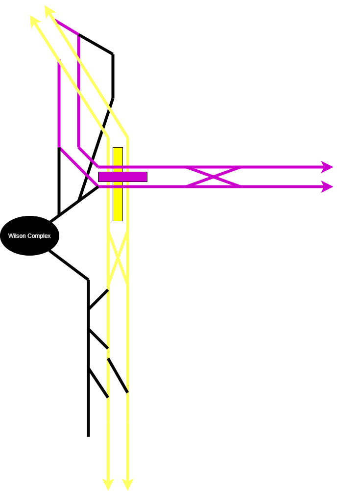

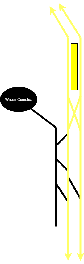

To be clear, today the layout is roughly:
While an interline capable layout would be along the lines of:
This leaves me thinking your idea of what's being talked about is wildly off...
