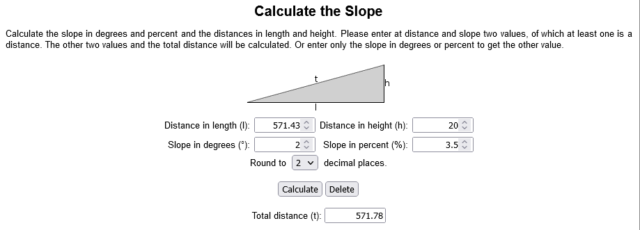

As a side note for others, you may wonder how to calculate the distance required for gradient (to climb to a certain height).
The answer is to use a calculator for that purpose, and insert the estimated height climb required, and max. slope and it will give you back the distance.
For reference, most of the TTC subway is set to a max. grade of 3.5%; the Ontario line will be 4.5%
In the above example, I have inserted a grade of 3.5 and a vertical distance of 20 (I was thinking Meters, but it doesn't matter, in that as long as you read
the distance in height and length as the same unit, your good.
Note then, that if you ascend 20M, at 3.5% you require 571M
Obviously, in this case the depth of a not yet built station isn't knowable, but 20M is a fairly reasonable assumption. Sheppard's stations range from 13M-18M deep, but the tunnels were all done cut-and-cover, and as such are closer to the surface than is likely for most new construction.
Note that any grade change from below ground to sufficiently elevated to clear railway or highway will be greater than this.

As a side note for others, you may wonder how to calculate the distance require for gradient (to climb to a certain height).
In the above example, I have inserted a grade of 3.5 and a distance of 20 (I was thinking Meters, but it doesn't matter, in that as long as read
Note then, that ascend 20M, at 3.5% you require 571M
Obviously, in this case the depth of a not yet built station isn't knowable, but 20M is a fairly reasonable assumption. Sheppard's stations range from 13M-18M deep, but the tunnels were all done cut-and-cover, and as such are closer to the surface that is likely for most new construction.
Not that any grade change from below ground to sufficiently elevated to clear railway or highway will be greater than this.
Good post as it shows what the distance is needed to get to x height using various types of grade. The rule of thumb for me has been 100 feet per 1 feet in height equal 1%.
You need more distance added to the slope and the height to do the transition from grade to slop that various on the slope %. This applies at both ends for what you want to climb that you will see curb areas for that transition..
