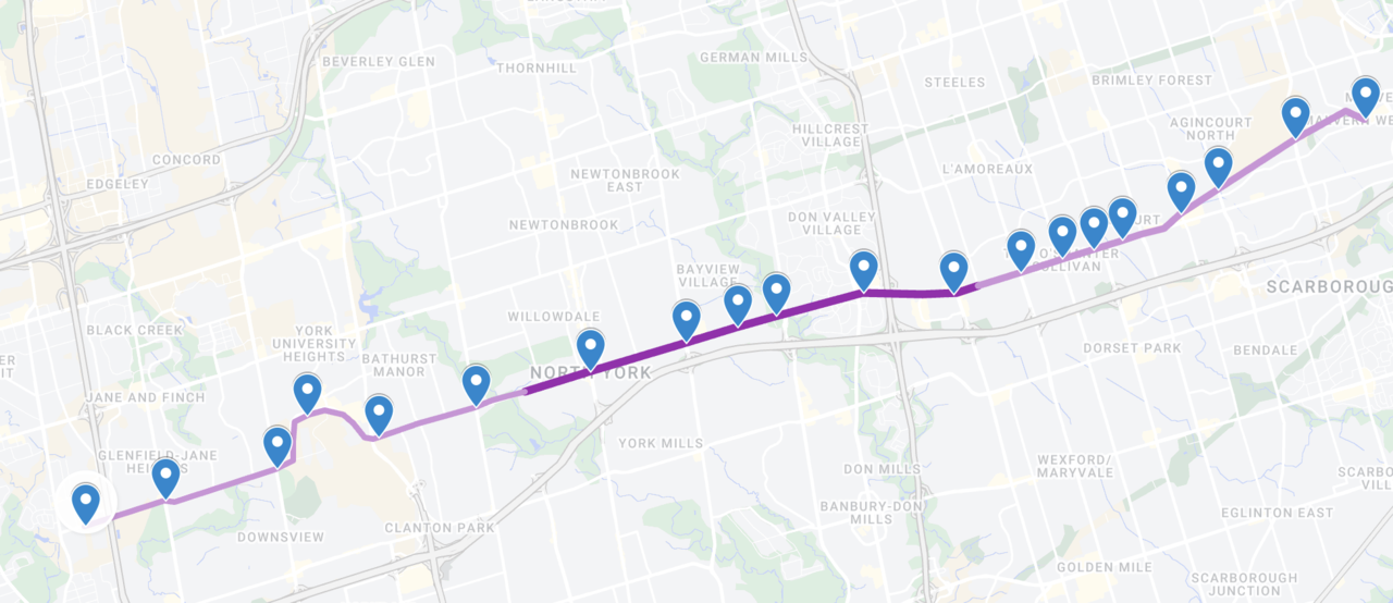

Light purple being elevated, dark purple is underground
this is the direction i'd like to see take shape if they are going to expand Line 4 at all.
a true orbital line would be even better.
this is veering towards complete fantasy, but an orbital line like this would have connections to every TTC & GO line (excluding Lakesore East) and that would be immensely beneficial to the entire system in my opinion.
I don't know why you'd veer so far north at Sheppard. There's no need for a second interchange with line 1. The Downsview Park and airport area would be much better served if it crossed the Barrie line a bit to the south end of the station, of not miss it entirely, and run past Centennial College.
