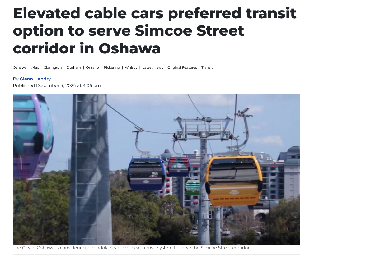

For the preview deprived and the click-averse we need to bring forward the headline and associated picture:
There is a case for technology of this type in certain applications.............but I don't think Simcoe St. in Oshawa is that case.
I don’t really think gondolas fit for singular urban corridors at all, honestly.
They do best where there is a grade that cannot be climbed reasonably by any other mode. Flying over hilly neighbourhoods in South American cities, or wherever else. They are essentially in lieu of a funicular- “connectors” really.
The Hamilton escarpment could make better use of this tech, or to connect a hypothetical GO station in the Don valley to Broadview or Castle Frank station. But as either case would demonstrate, the tech couldn’t really be true rapid transit for the actual, identified corridors.

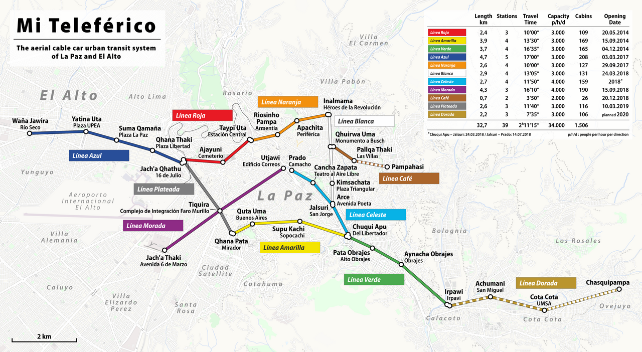

Looking elsewhere, the 1.1 km line in London take 5 minutes - 13.2 km/hr. Le Pas in Bolivia (also very mountainous) has an extensive system, but even there the longest is 4.7 km and takes 17 minute for the 5 stations. That's still only 16.6 km/hr.
So why everywhere else are the lines so short? Most troubling, is that if you look at the Le Pas map - surely the biggest system there is, the lines seem to run not as one line, but the main east-west axis is actually 5 lines totalling 17.1 km and a travel time of 66.3 minutes (15.5 km/hr not including transfers!)
