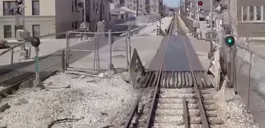

Watch this video in real time from Chicago's Brown Line. Watch for the level crossings and see.
An 80-minute video with the level crossings towards the end? That's kind of cruel. This isn't some kind of Socratic lesson.
Jump to 1:18:15 - the third rail has breaks:
