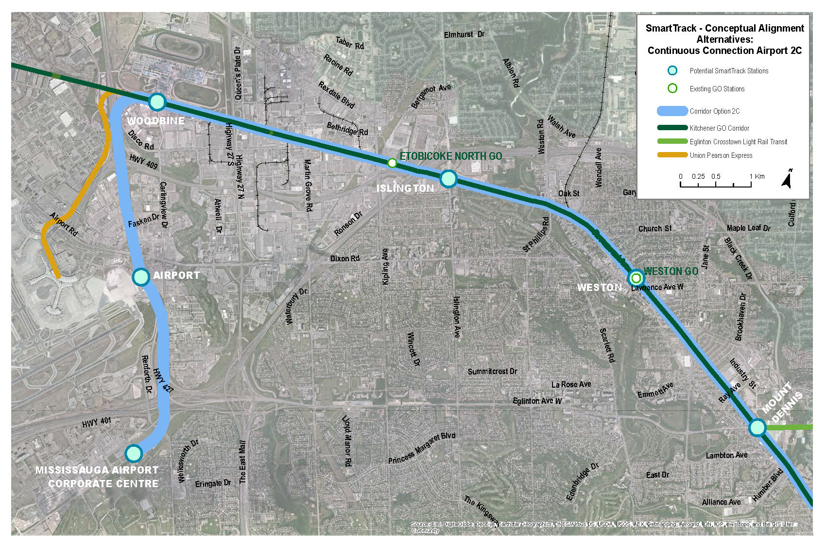

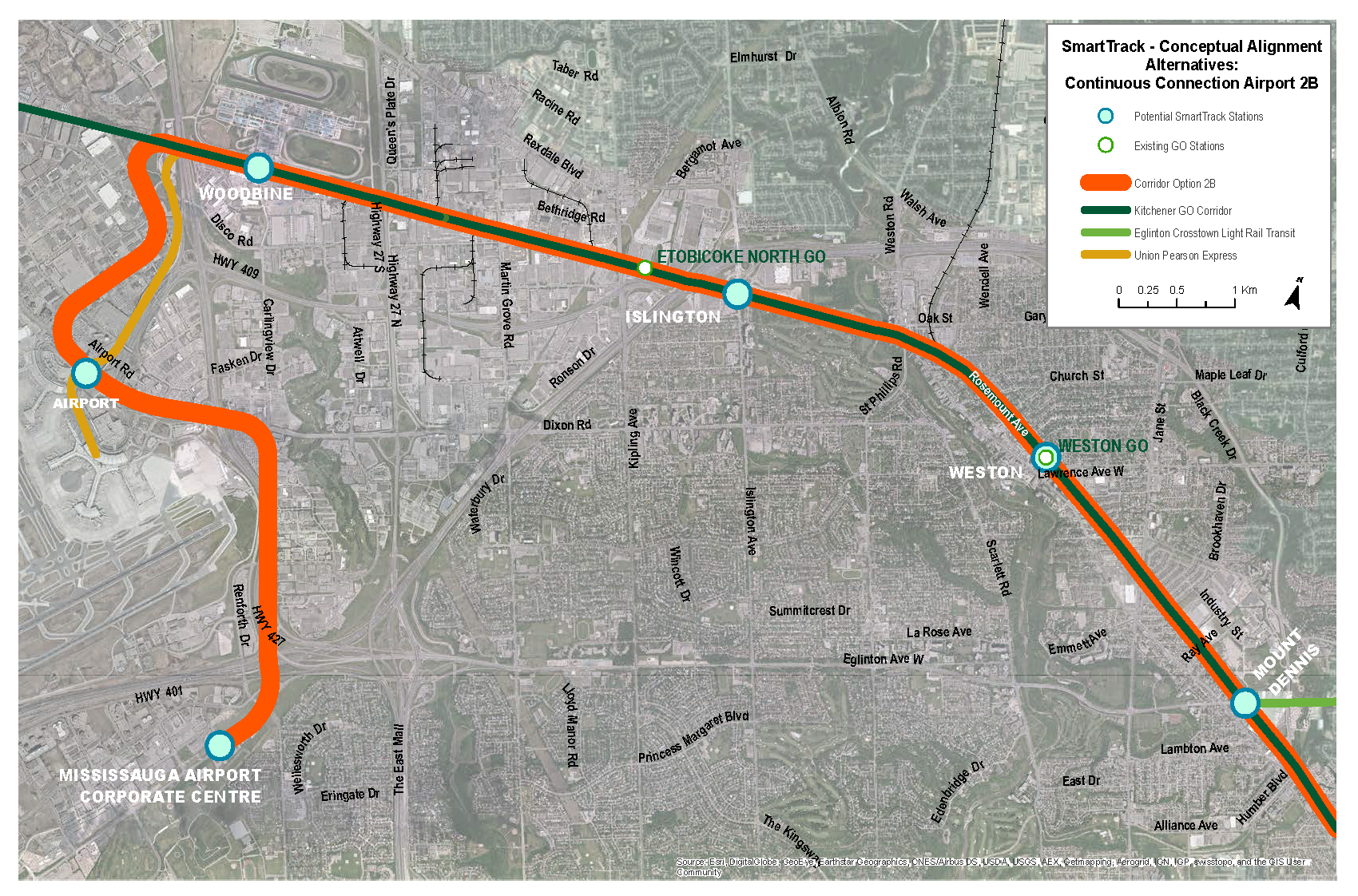

So I just surprised myself and stumbled upon the different alignments that are being studied for SmartTrack on the City of Toronto website. I regret if it isn't too organized but here they are:
View attachment 48335View attachment 48336View attachment 48337
We've been talking on or off about the possibility of these alignments.
I didn't think the City would actually be studying them!
If SmartTrack reaches AAC via Pearson via the Kitchener line, it really is not a bad transit investment. We can still build Eglinton Crosstown extension to a natural terminus with SmartTrack at AAC.

There are more important things than just ridership, such as connectivity. Something people on UT seem to often forget. This would connect with two major regional nodes, Pearson Airport and AAC. Both Pearson and AAC are massive employment centers.
How much is it a chicken or the egg scenario here? Is the low ridership numbers a result of the low level of transit options? AAC is at present not the most transit friendly employment node in the Toronto area.
Also the Eglinton extension's primary purpose would still be funneling people eastbound to Mt. Dennis. Counter-direction service to AAC is just a plus.

And neither are in Toronto. It shouldn't be city money building this. And neither draw significantly from the Eglinton corridor - the Eglinton line studies showed that - which is why the line was cut back at Jane (and later Mount Dennis)
