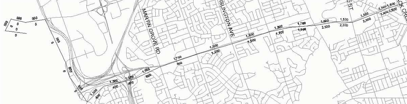

Here's the complete picture.
The numbers here are significantly less than the peak ridership for Finch or Sheppard LRT which will both be non-grade separated. On Eglinton, the maximum is 5400 somewhere in the tunnelled section.
400 per hour is at Renforth. Further east, where elevation is proposed, there will be more riders.
True. 900 at Martin Grove. 1,300 at Kipling. 1,500 at Islington. It's only at Jane that it starts to get borderline acceptable with 2,900. Perhaps they should terminate it at Jane.
Terminating at Jane would create another artificial transfer. LRT does not cost that much, it should be continuous and it should connect to all N-S routes.
The western section of Eglinton LRT can be designed in multiple ways; one option is to elevate it only over major intersections. Some of those intersections have been depressed to facilitate the Richview Expressway, and now this feature can facilitate the LRT instead. Elevating the whole LRT line may not be necessary in that case.
