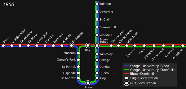

Let's look at the trains coming down Yonge - it would be the exact same as what we have today. But instead of going around the U and heading off to Yorkdale, they would turn onto the Bloor line. Alternate trains would go east (green line) and west (blue line).
Say the green line trains come every 2 minutes, stagered with the blue line trains that come every 2 minutes. This means that Bloor-Danforth will only have trains every 4 minutes. That's where the straight B-D train (red line) comes in - it fills in the space to have trains every 2 minutes on the B-D line as well.
  • So if you are at Pape, a green line train will come to take you downtown, followed 2 minutes later by a red line train that takes you West to Kipling. If you are heading downtown, you catch the green train (you may have to skip the first red train you see, but waiting the 2 minutes to avoid a transfer is a good deal). Although if you want to access Wellesley or College, you make want to take any train (red or green) and make the transfer at Y-B (just as today) and switch to either a green or blue train.
  • If you are at Dufferin, a blue line train will come to take you downtown, followed 2 minutes later by a red line train that takes you East to Kennedy. If you are heading downtown, you catch the blue train (you may have to skip the first red train you see, but waiting the 2 minutes to avoid a transfer is a good deal). Although if you want to access Wellesley or College, you do just as well catching a red train, to make the transfer at Y-B and switch to either a green or blue train.
  • If you are at Eglinton, a blue line train will come to take you downtown (and eventually heads off to Kipling*), followed 2 minutes later with a green line train that takes you downtown (and eventually heads off to Kennedy*). If you are heading either West* or East* you will most likely make the transfer at Y-B (just as today) instead of riding all the way down through the U.
Now, since more people can make it downtown without a transfer, it reduced the number of transfers at Y-B. This reduces the loading and unload time at Y-B - with this long time affecting the frequency of trains that you can be shoved southbound (at am peak) down toward Wellesley. With current loads, this single station affects the timing on the entire YUS line. By reducing this station dwell time, we can actually send MORE trains down the Yonge line than we currently have. This wouldn't be a huge amount, but perhaps 5% to 10% more trains could pass through in a typical hour. I assumed the 2 minute frequency above, which is perhaps aggressive for today, but not with full ATC and not with an improved terminal station when Yonge subway is extended to Richmond Hill. So the train frequency might improve with this interline from 120 seconds to 110 seconds - which would translate into an extra 2 or 3,000 passengers per direction per hour. Plus the more convenient trip downtown for those coming across the B-D Line.
