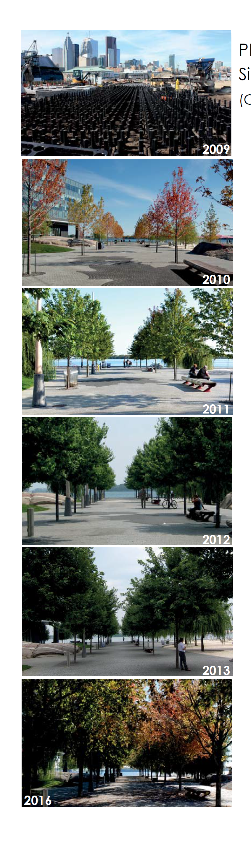

Interesting Document from Waterfront Toronto: https://www.waterfrontoronto.ca/nbe...760fe28cc0/02_LovePark_DecDRP.pdf?MOD=AJPERES
Which includes this graphic on success of Silva Cells at Sugar Beach:
There are a lot of great ideas in the report. Beautiful pictures. What it lacks is any of the very many geese that will move in.
The photos are remarkable! For once a Toronto project that actually looks like the renders.
